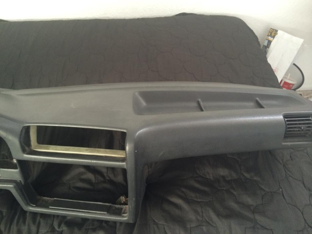

                          Bought a new crackless dash and rear center console. $175 so not too bad.
