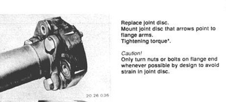

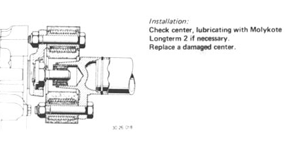

                            alingment of front driveshaft yoke to guibo is not important if you only removed the three bolts and put it back one of the three ways it could go back on . if you completely removed the guibo from both the yokes (trans and driveshaft then you do need to align the arrows on the guibo correctly ,but this is only because of premature wear out if not done right,see pic )
                            i think you are thinking of the two piece driveshafts were it is critical to mark them if they come apart in center to correctly align the U-joints, but IX is only one piece and any of the three positions is ok . also make sure alignment centering pin and bushing are ok as if they are bent/missing it will cause a vibration also
