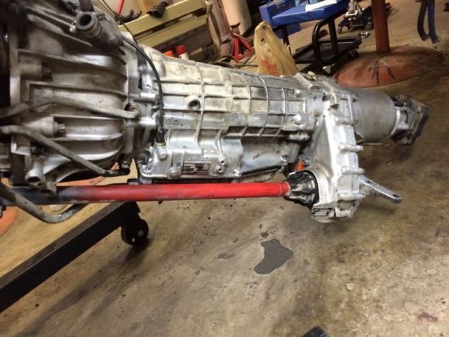

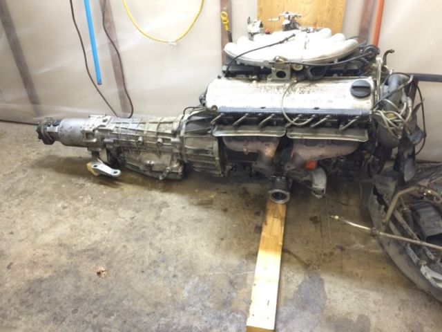

    FS: 89 325ix complete engine, auto trans, transfer case, front & rear drive shafts
    Was working great when I pulled it out a week ago to start a v8 swap. Compression is 135-140 on all cylinders and I have a video of it running but I am not sure of its history
    Price includes complete unit: engine, alternator, AC compressor, auto transmission , transfer case, front and rear drive shafts.
    I will separate the parts but would prefer to sell as one complete unit ready to install
    Located in Calagary, AB Canada
    Asking $1250 obo. Make me an offer

    Here is the other side if the assembly
