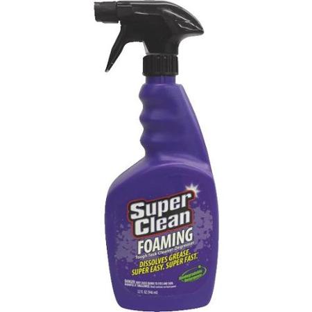

          i can't speak for the op, but:
          vatozone and other places sell a degreaser called "super clean" in a purple bottle. i use this stuff with a stiff plastic brush and a gasoline powered pressure washer. my parts look like this or better when i get done. it is an oxide based cleaner that is a bit caustic. you will definitely want to use nitrile gives with it. also, it causes aluminum to corrode quickly after its use. i always spray or wipe a light oil over everything i clean.

            yeah I've used that stuff. I haven't really had that great of luck with it, but I don't have a pressure washer. I used a pressure washer when I did my 5 speed without any cleaner and it came out pretty good, so I'm not really sure that purple stuff does a whole lot (other than stain aluminum parts).
            I like to use a chlorine based degreaser but it's pretty nasty and then you have a solvent to dispose of. It melts off the grease though.

                speaking from experience, i can say that i have used tons of cleaners over the years. simple green, purple power, kerosine..... the one i mentioned above called "super clean" in the purple bottle is absolutely phenomenal. think night and day. the pressure washer is great, but it won't come close to getting everything. since it is oxide based, the aluminum will be shiny like new when you are finished, but it will oxidize quickly if you don't put something over it for protection. i think it was about 6 or 7 bucks a bottle.

                • 2santiago
                  • Aug 2015
                  • 84
                  Here's what I used
