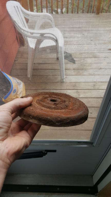

    Can someone post a picture of an IX spring hat?
    I think I may be running a RWD hat. I have never bothered to double check it (why would I, it came with the car) and I can't eliminate this binding. I added a second washer, because it was rubbing, but now it feels better. But it's still weird. There's a lot of resistance initially, and then it's smooth. Before it would bind up on each of the cross shaped dimples.

    i'll take a pic tonight. i have a new one off the car.

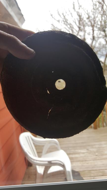

              if your strut is binding, just order two of them, i had the same issue, turns out my spring perch was collapsed. they arent a lot of money and you will see the difference once you get the new one

                  Well, I think I have the right part then. I don't remember holes in them like these. https://www.ecstuning.com/BMW-E30-32..._2.5L/ES50526/

                    lol lemme see if i still have my old one
                    • 2002tiiguy
                      • Jul 2013
                      • 467
                      the bottom of the strut mount was sliding on the spring perch, dunno how this one got so bad, got the car that way.
