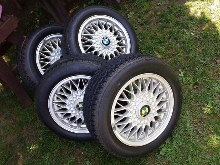

      Thank you.
      I do have the original fcatory 15” basket wheels. Two of the BMW center logo caps have yellowed on the two wheels that were stored on top. Those can be easily changed. I think the tires may be the originals or really old. They are UNIROYAL ralye 205/55/15 tires. They look almost new hold air and free of cracks, but really hard rubber and naturally not safe to use. I had checked the date code on them before but don’t recall if I had seen 1988/89 or 1991. I can transer the new Dunlop tires on the Ronal’s to these original wheels. That will probably be the last thing I decide on after I have the car back.

        I'd leave the Ronals man, they are nice wheels. Period correct and also NLA for a while now.

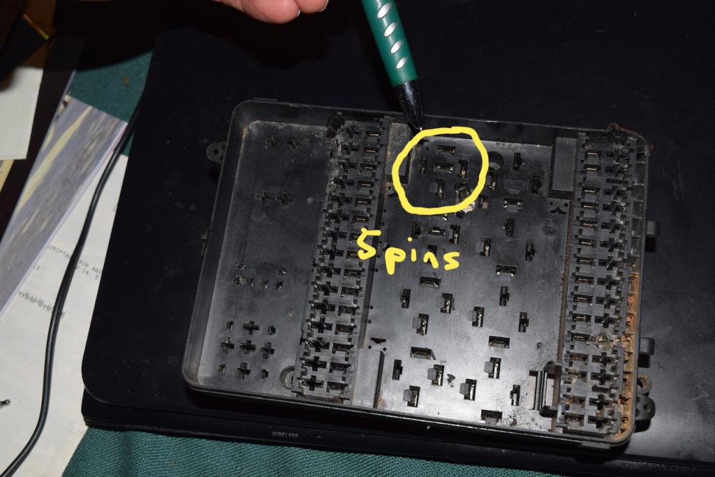

            Replace,ent fuse box is incorrect unit
            Turns out the fuse box I bought from ECS Nov 2016 is the incorrect unit. Not blaming ECS as it appears Real OEM and other places list the part I bought as the one that supersedes the original. My car has the ellipsoid head lights and I believe that changes things. I do not know which exact part number matches my fuse box in the ix as it no longer has legible part numbers so need to go with what info I find out there on the web. Using my VIN for reference in searches did not help.
            The part I bought from ECS is 61131370763 which fits most E30's.
            The part I believe I need is NLA 61131370761 which shows as a Euro fuse box.
            My Canadian spec 88 E24 M6 has a fuse box with label part number 61131386386 which Real OEM also lists as NLA and are also showing the same part I bought ending with the 1169 as its replacement. My M6 also has the ellipsoid headlights and its fuse box should work on my ix E30. That new part Real OEM shows would not work on my M6 either.
            Now I’m going to have to spend stupid money on some NLA fuse box from some special place or person if I can find one as I do not wish to modify anything.
            The attached images are of the original box from the ix. Note the circled area with a five pin connector for the relay. All the newer parts come with a 4 hole pin connector in that same place. If anyone has any in put it would be greatly appropriated.

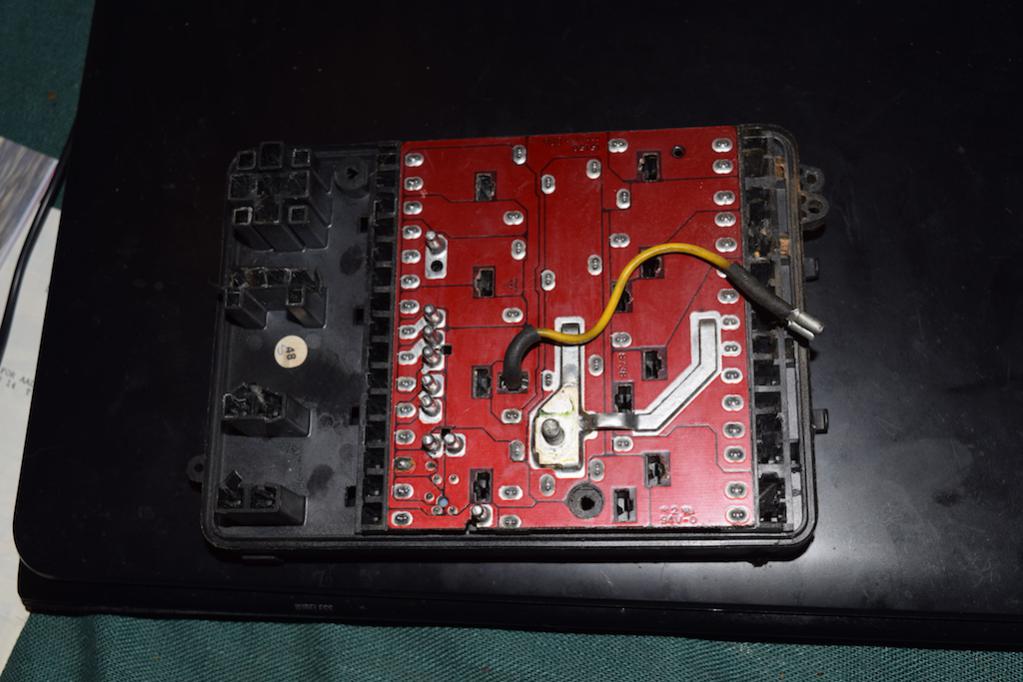

              Back side of current fuse box
              Here is the back side of the current fuse box needing replacement

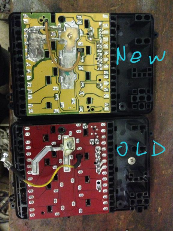

                        The pcb is not different between the ix and the standard rwd E30. But the pcb is different pertaining to the year of the vehicles.
                        At some point BMW "updated" the pcb color(red to green)and headlight relay from a four pole relay to a five pole relay. That is it. There is nothing else different.
                        If you look at the wiring diagrams for the headlights between 89 and earlier and compare them with 90 and later you will see the difference between them.

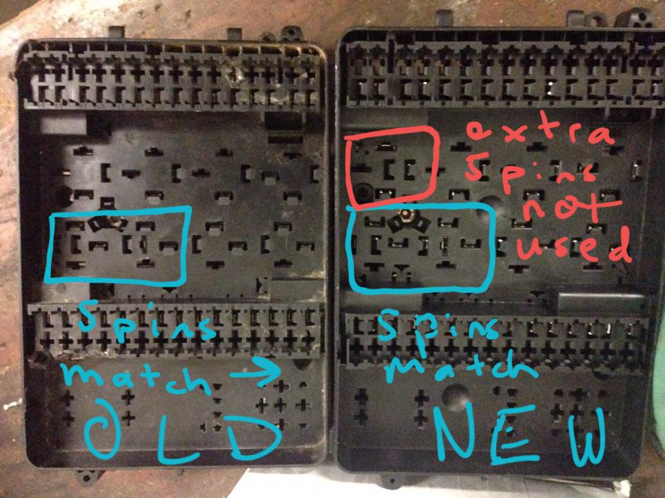

                          Ok. So here’s the final update on the fuse box. After some research I ended up finding the appropriate fuse box and able to source it via ECStunning. What wired is that when you search ECS’s site for fuse box specific to the E30 this replacement part for the red board type never shows up but if you put in the specific part number it displays.
                          The part that replaces the red board type fuse box is 61131386387. The board is bot red or green but beige. It was also less costly than the first box I purchased and for those needing red board replacements it is new vs sourcing a used one or needing to rewire to accomodate the five pin relay slots.
                          For those that asked what the two 5 pin relay slots are for, its is the headlights and fog lights. My car has the elipsoid lights.
                          Max

                            Here is the back side.
                            Red board is the original. Beige is the good replacement.
