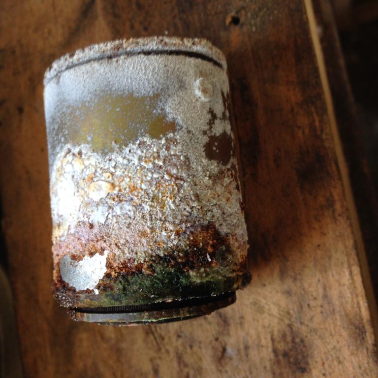

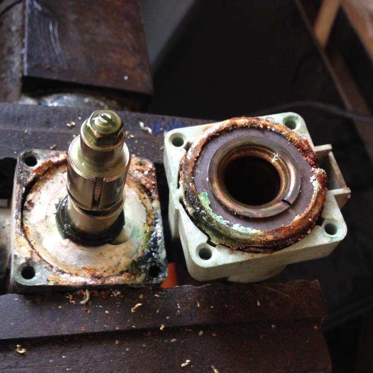

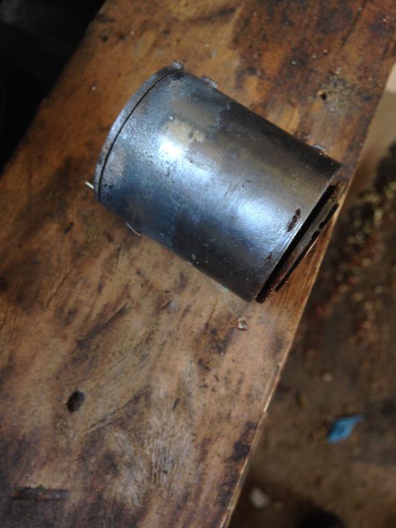

    So, this is why you don't just clean up the exterior of some parts. The inside guts really count.
    This is the heater valve.
    First picture, the exterior, second is the exterior cleaned up which looks ok. Then we decide to drill out the rivets and check the guts since is appeared to be leaking slightly. The thought was to replace the o-ring inside and replace the rivets with screws and washers. Looks like we are going with a new unit. Has anyone had experience with servicing the heater valve vs replacing. Just curious.

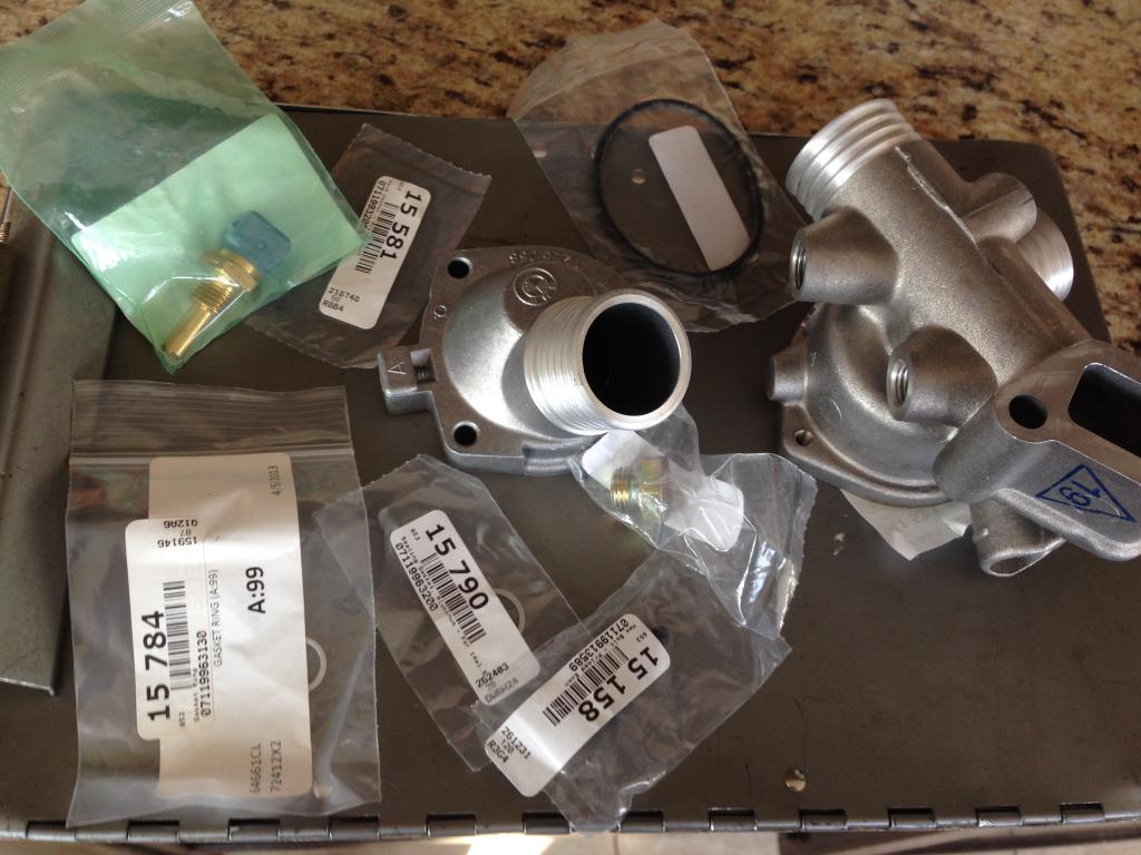

    The last picture is of more parts that arrived. New thermostat housing, cover, related o-ring & screws and temp sensor. All BMW parts with exception of temp sensor being Bosch.

      Mine had stopped working because it was clogged with cooling system tablets, but it was not leaking, so the metal parts were not corroded like those. I cleaned all the junk out of it, then reassembled and it works fairly well, although I forgot the steel shell around the coil so it may not be working as max capacity.

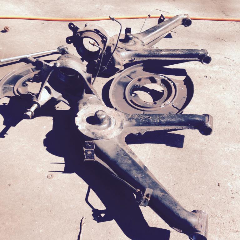

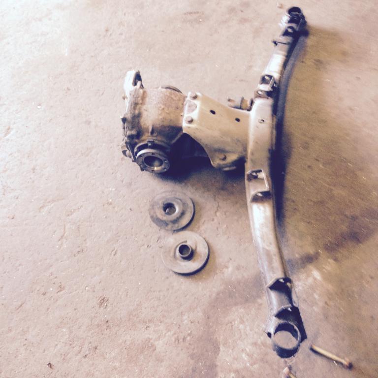

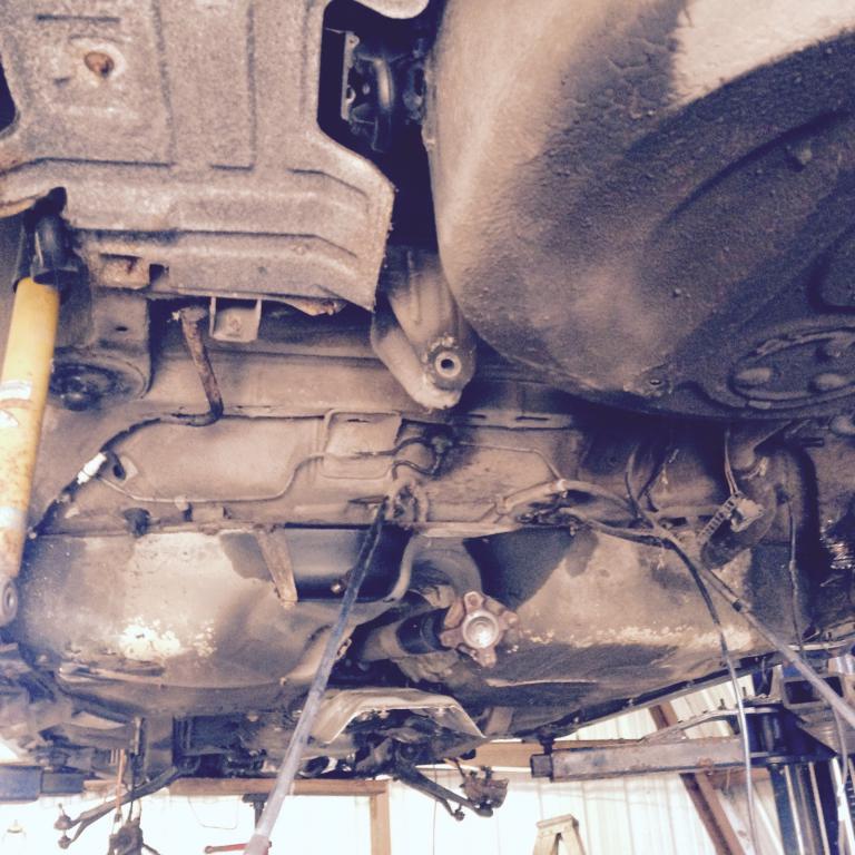

        As we continue....The under side does not look bad. Its dirty with nearly 30 years of dirt but no rot or rust issues.
        Its all coming out, getting cleaned and refreshed.
        Some more pictures.
        Underside
        Rear subframe
        Rear sub axels
        Rear breaks
        Etc

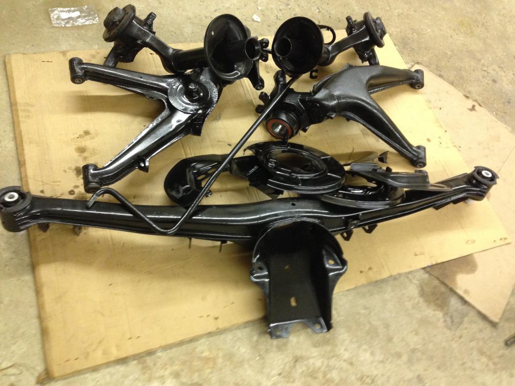

            Progress....
            Its been a while. Progress is being made.
            Got the incorect heater control vlave, they sent me the one for the plastic heater core inlets. I need the other version. If anyone knows where to get the correct ones please let me know. I want new, not used.

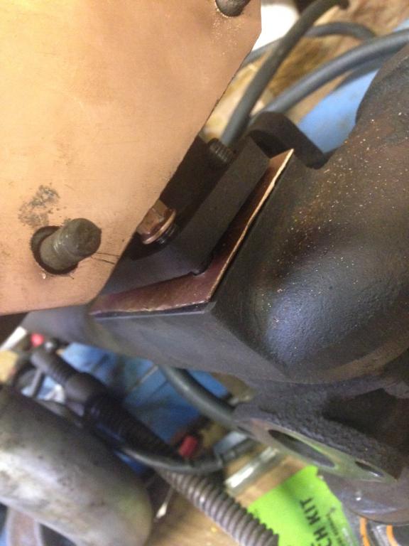

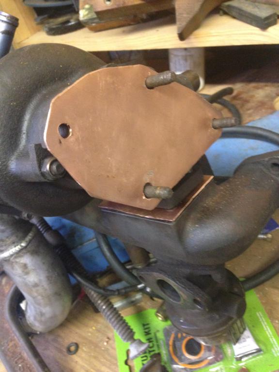

            We started making the gaskets for the Dinan turbo and exhaust components since they are all NLA. We chose to make them out of copper sheets. Went with the thickness right inbetween what the standard and heavy duty gaskets would have been. A couple of Pictures of the process being started is below.

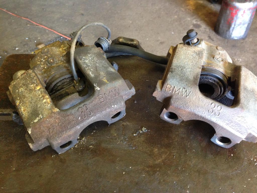

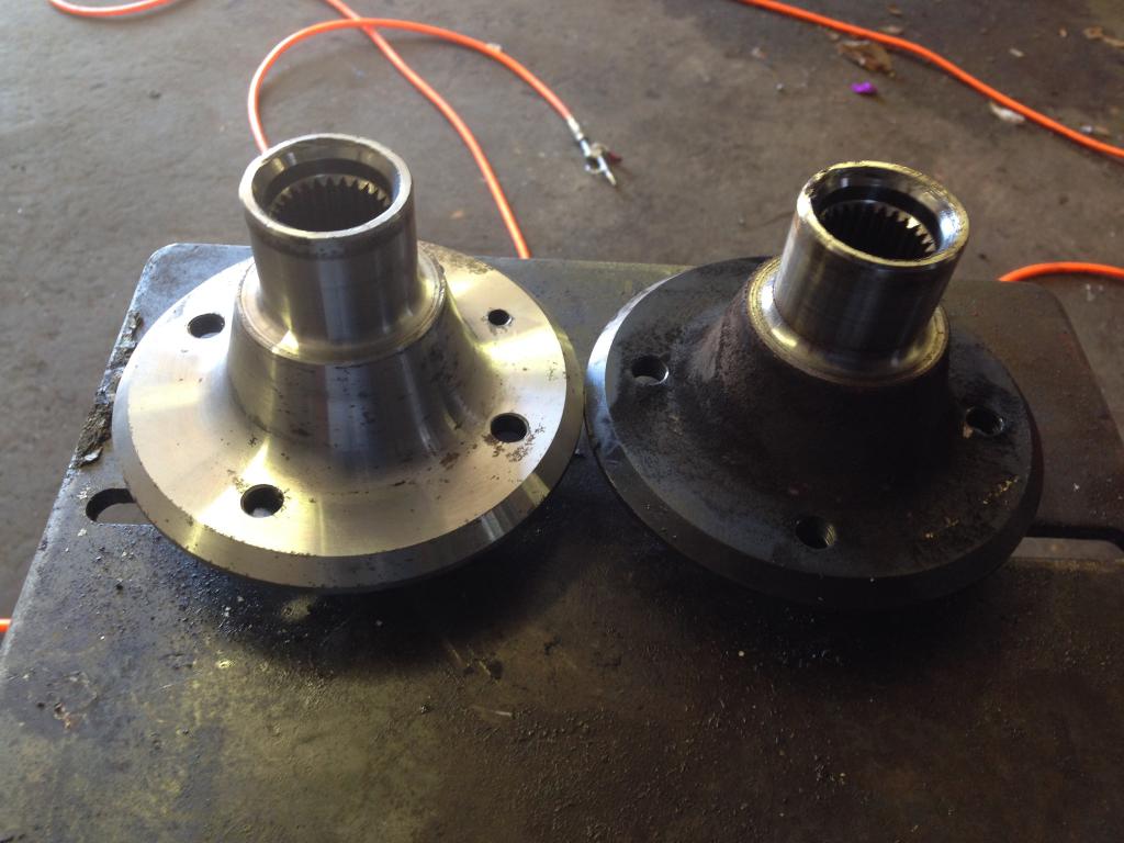

            Also included is a picture of some of the underside rear compents after cleanup, blasting, and repaint/sealing. We replaced the bushings etc. The rear bearings have also been replaced. Naturally we replaced the rear subframe bushings. You can see the before picture on post 48 two before this one. Its the second picture. Big difference.
            Its also been decided to replace all the fuel and break lines.
            New Bilstein HD shocks for the rears and struct inserts for the front are most likely being ordered or if not we will restore the current units. Whats on the car now are the original units Dinan used whch the stampings on them matched to the HD units after talking with Bilstein. We believe they may have been revalved as Bilstein advised that the HD shocks are meant for the factory standard height. The car is lowered with Dinan springs. This is going to need to be tested and matched. Bilstein did offer to have them serviced. If I ship them they will restore them with new oil amd seals keeping what ever revalving had been done intact. What I don't like is they wont repaint them and make them look fresh thus if new units will work I'd prefer that than having tompaintbthe old ones.... jurry is still out on this ome.
            I still need to source a new muffler. The Dinan unit has a rust whole. If anyone has one for sale I may be interested otherwise, I am going to source a Eberspaecher muffler which is what Dinan used as the core for its modified version. If anyone knows of a good source for the OEM Eberspaecher mufflers please let me know.
            More to come soon as we should have it back on the road for testing soon.

              As far as the turbo gaskets, unless Dinan themselves had custom housings cast, all the gaskets are available from the turbo MFGR's (as well as aftermarket). Looks to be a typical t3/t25 manifold gasket and Garret 5 bolt waste gate housing. BUT, copper sheet works just as well :)

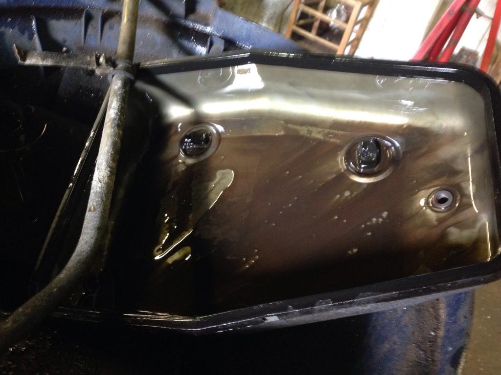

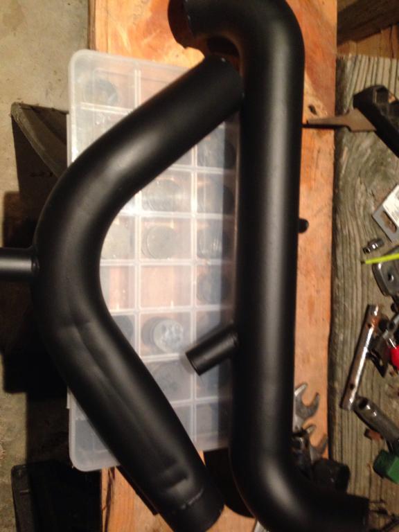

                                Mini update:
                                Originally I orderered and installed (I should say Steve-mechanic installed) the thicker front flex disc/guibo. Last week Steve advised me that the bolts do not have enough clearance. After reading through a thread here on r3vlimited, it looks like additional steps are needed. Cutting the bolts or shorter bolts, X5 centeriing flange etc... I did not want to make Steve spend time on additional modifications since I am restoring this car to how Dinan had done it in the 80’s I decided to revert back to the original sized OEM flex disc. As recent luck would have it, the BMW units are on BO at ECS, BAVAUTO plus several other sources. Steve found 4 units in the US via his contacts, one will arrive July 22nd. A few more misc items have been order such as a replacement handle for the hand break (current unit had a small hair line crack)... you know ... the “while I am at there” syndrome.
                                The rear end and front end have been put back together. After the original flex disc arrives and the drive shaft gets put back into the car it will be sent to a custom exhaust shop to fabricate a replica of the custom Dinan down pipe (I thinnk thats the part) becuase the exisiting unit is a little tired, pitted and has a few pin holes. Rather than just do a cheap patch with welds we are going to have a new one made. Here is where I wish the tech for 3D printers were farther along and accessible. After this we should be close! Then we begin tweeking and addressing things that may pop up with testing. It ran before we started this process this we donÂ’t expect much to come up.
                                On a side note, not to highjack my own thread... I came across a nice example of a one owner low mile garage kept 1991 E30 325i convertible. I havenÂ’t committed to it yet but I am having a hard time passing it up. I am thinking daily driver but, originally my 1988 M6 was suppsed to be my daily, then this 1989 Dinan ix was supposed to be my daily becuase the M6 should not be one... and now I am thinking this ix shouldnÂ’t be one either.

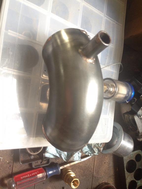

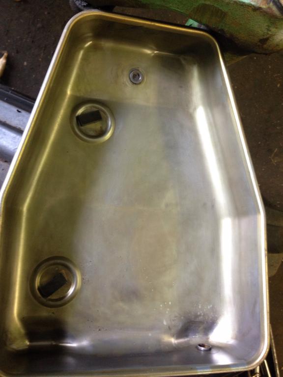

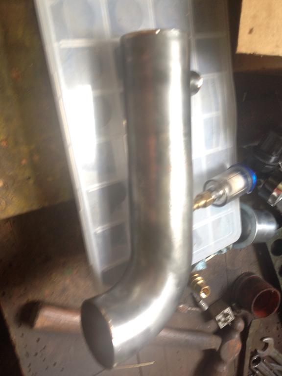

                                In the meantime here are a few misc pictures of progress...the transmission pan before and after plus a few of the turbo pipes after clean up polish and or repainted.
