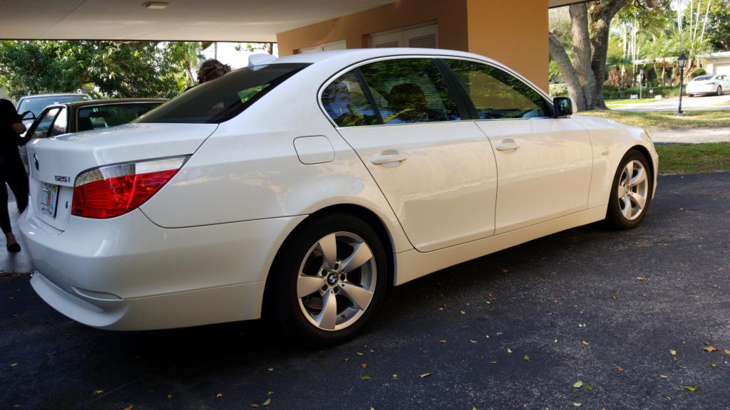

      On a side note, I originally had intended to make this 325ix my daily driver. Took a little longer than I anticipated... I originally thought I’d have it done in six months, not two plus years. So, two weeks ago I bought an another bimmer to be my proper daily driver.
      Picked up a really nice one owner super clean 100 % original paint free of scratches, blemishes or even stone chips.
      2007 525i with 58K miles white with that orange redish brownish leather interior.
