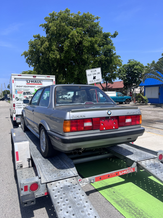

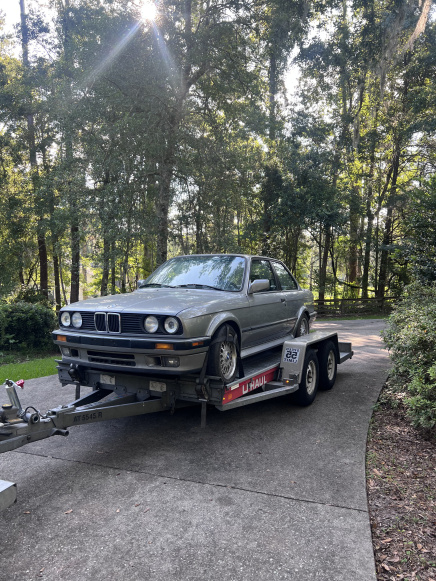

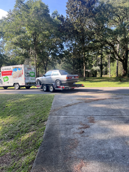

                  #113
                  Finally a proper update. Got the Hotel and U-Haul Car Dolly booked for Wednesday July 5th. Heading up to Gainesville to pick it up. Heading back home Thursday July 6th. Will post some pictures along the way. I never thought that this would take nearly 7 years.
                  Hope the route home is trouble free.
                  Max

                    #114
ID:	10098345 Click image for larger version
ID:	10098344 Taking it hom
                    Max

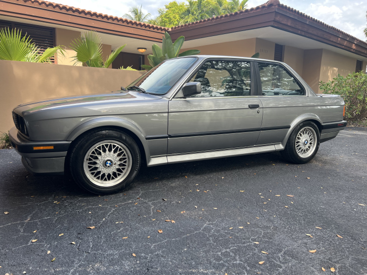

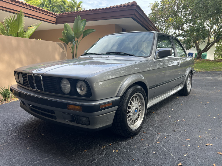

                        #116
                        Well….finally it is alive and on the road!!!!
                        Took a little longer than I expected. Looking back, I started this project Sept 2016. Wow, 8 years and 9 months later….A failed attempt two weeks ago had the car needing to be towed back to the shop. The engine cut after two days of test driving. It would not fire back up. Annoyingly it turned out to be the fuel pump failed. So a new one was installed. This also resolved a random rough start and idle when the engine is cold. Until it warmed up to normal operating temp the rough idle remained. The shop and I thought it needed the injectors cleaned but that had been done already, or a fresh tuning due to the turbo system. The new fuel pump resolved the rough cold starts and idle. Now, it starts right up on the first try when cold and idles smooth. Here’s a quick couple of pics. I’ll post better pics once I have a better chance to properly detail it etc.
                        Max
