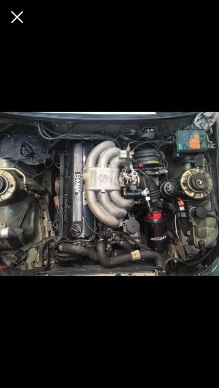

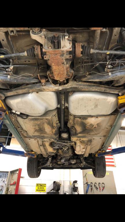

    Looking to purchase a 1988 325ix 5 speed with 254,000 miles. The current owner has replaced quite a bit of parts and has receipts to show for it as well as some as the P.O. before him. The car seems pretty clean for being in NY. The only problem with the car is it stalls out after warming up. The owner said he replaced the fuel pump before it started actIng up. The Stomp test produces the code 1211. ( dme control unit fault ) so I’m wondering if a couple hundred $$ in sensors and a 173 pin dme with the 1k resistor or even just another 153 pin dme would get it up and running again or if it’s not worth the headache. Guy seems to know his stuff and not just trying to dump off on someonelse as he first stated he wouldn’t sell until he fixed the stalling issue. Any info would be greatly appreciated.

    Might have mentioned it was running a Miller MAF conversion...

      Well the driveshaft is not connected, that's gonna give you running issues.
      :-P
      AWD > RWD

        Well I guess that’ll save me some money.. planned on replacing most sensors and relays anyways
          :-P
          Probably when he was replacing the guibos

            Get rid of the MAF conversion first and get it running well stock. There's a good chance it's caused by the MAF kit.
            Otherwise, these engines are really simple. Even if you had to replace every single sensor, there's only like.. 4. lol.

              Thanks for the info. Anyone happen to know where to find a good 173 dme? Would the Miller conversion throw the dme off causing the code?

                    Neither of these parts are unique to the IX, so post a "Wanted" ad in the Classified section and/or watch for a part out of a wrecked car that was running at the time.
                    You need to have a "173" DME or higher for better test capabilities. Like Nando said, get a stock one (not a chipped one) for now until you can get the engine running correctly.
                    The BMW stomp test explained: pull check-engine codes with no tools, and why the 173 ECU beats the 153 for diagnostics.
                    For the air flow meter (AFM), make sure you're getting a M20B25 "i" version, not the M20B27 "eta" version.
                    Stalling when warm could be caused by a number of other issues as well, but convert back to the factory components first and go from there.

                            Auto and Manuals use the same DME. The 1K resistor is for the early ix ABS - you can put it on pin 19 of your C101 as well, but you may or may not need it at all. This was actually a common dealer repair with the '88ix even when it was new/stock.
