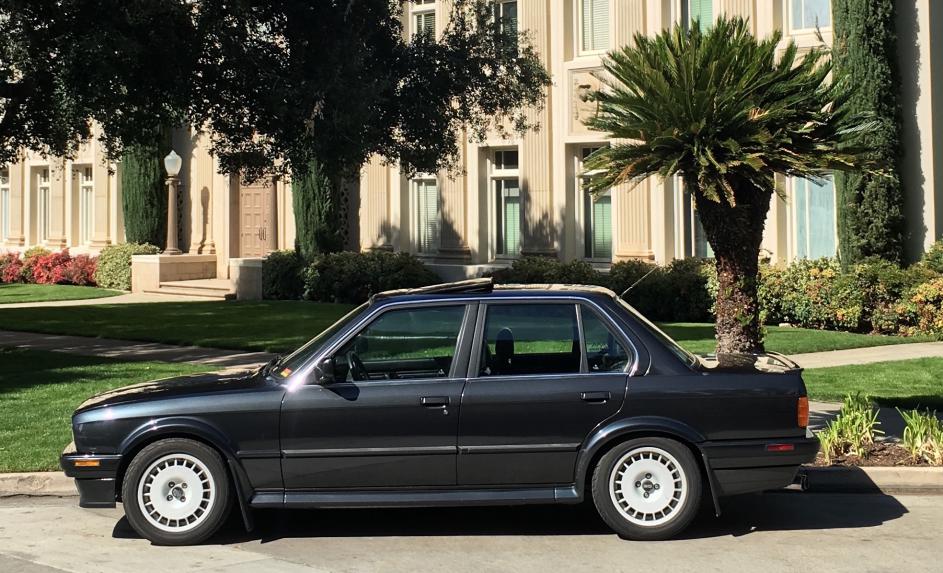

    Here's a shot of the car on level ground, for those wondering how low it is.

      Do you go full lock whenever you park?
      • nando
        • 34844
        it's on the outer edge so I'd say you're OK for a little while. If it was on the inside it would rip much quicker, spewing nasty grease everywhere.
        And yeah, I agree yours isn't all that low (looks fantastic though!).
