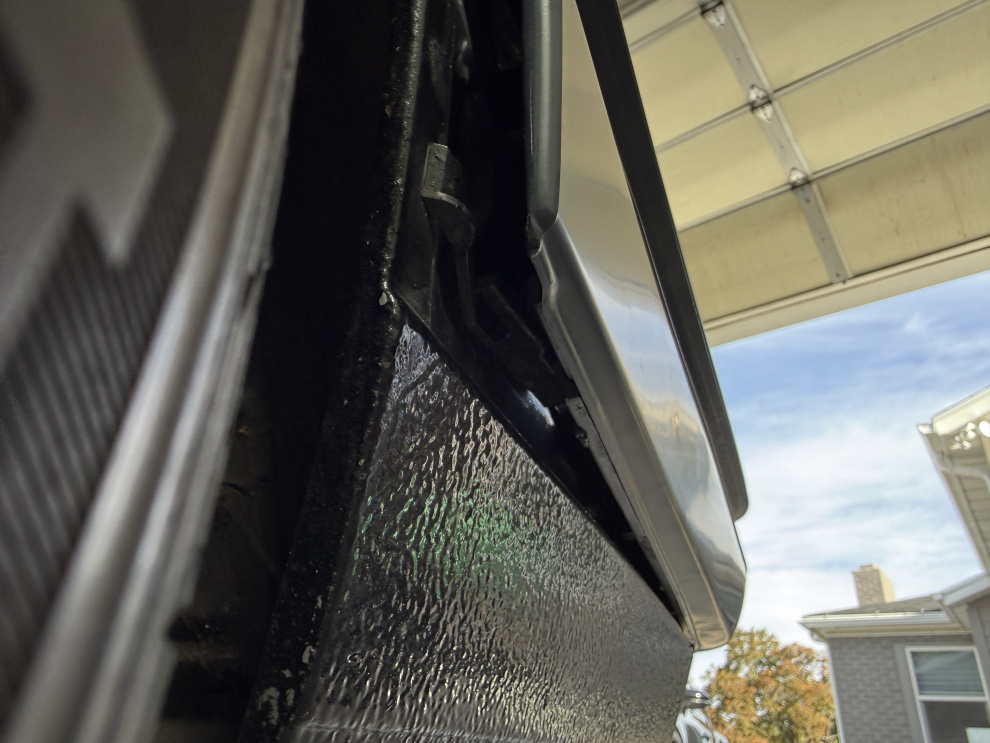

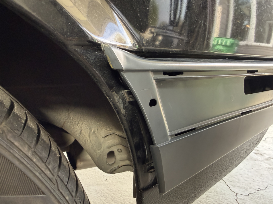

    I bought a new rear bumper for my '91 and I for the life of me can NOT get it to fit properly. Does anyone have any tips or tricks to getting it to fit correctly? I can't seem to get the sides of the bumper to connect to the side bracket without issues. So if anyone has tips that would be greatly appreciated. Thanks!

    I can also take pictures if that would be helpful.

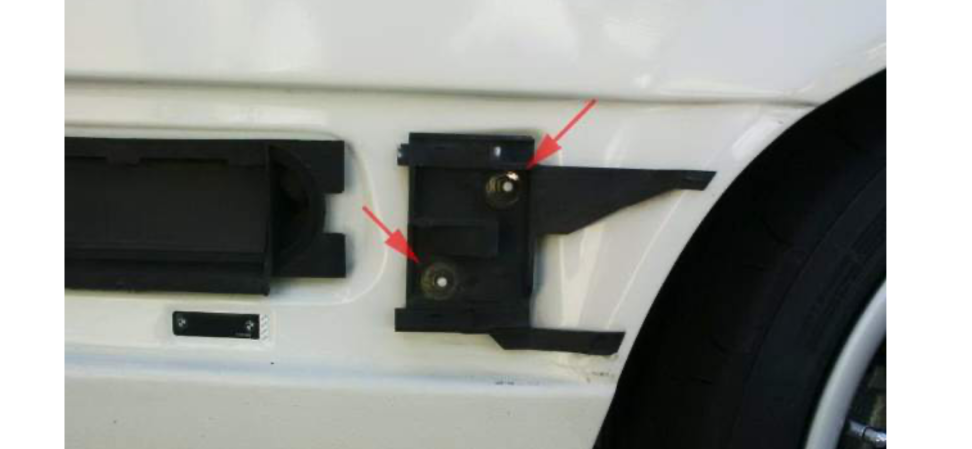

      Yea take some pics. The brackets should have a little room to help the alignment to help slide in (#4 & 5).

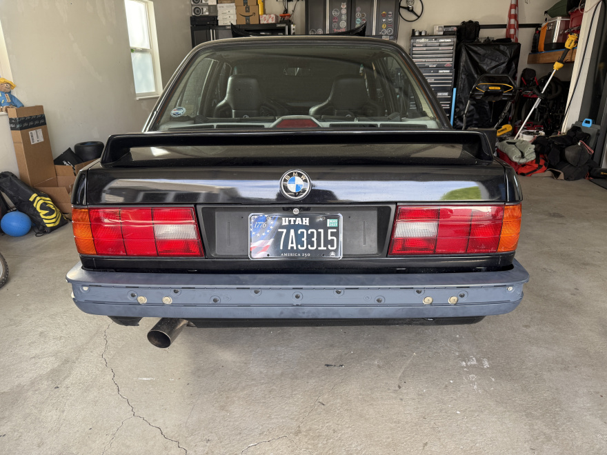

            1991 4 door, here she sits in the driveway bumperless.

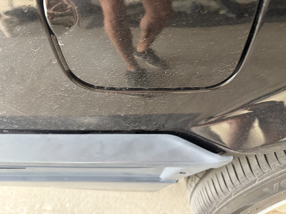

ID:	10166857 Click image for larger version
ID:	10166858 Click image for larger version
ID:	10166859 Click image for larger version
ID:	10166860 Click image for larger version

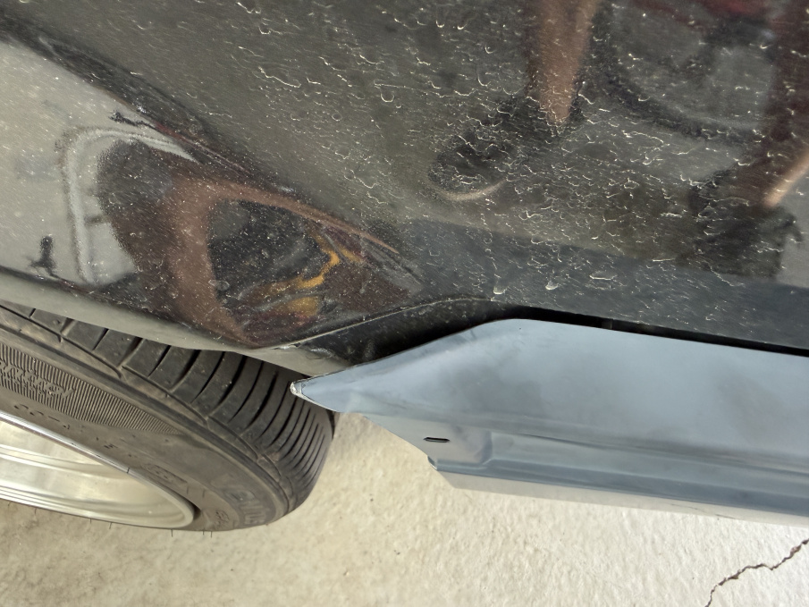

ID:	10166861 Here are some pics of the bumper that I threw on the car this morning.

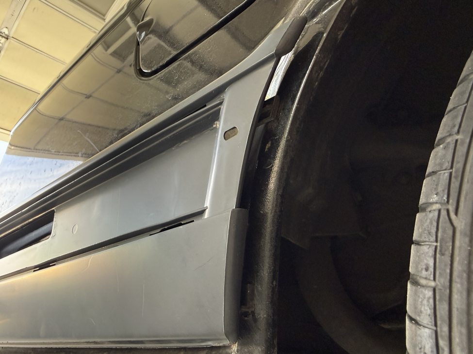

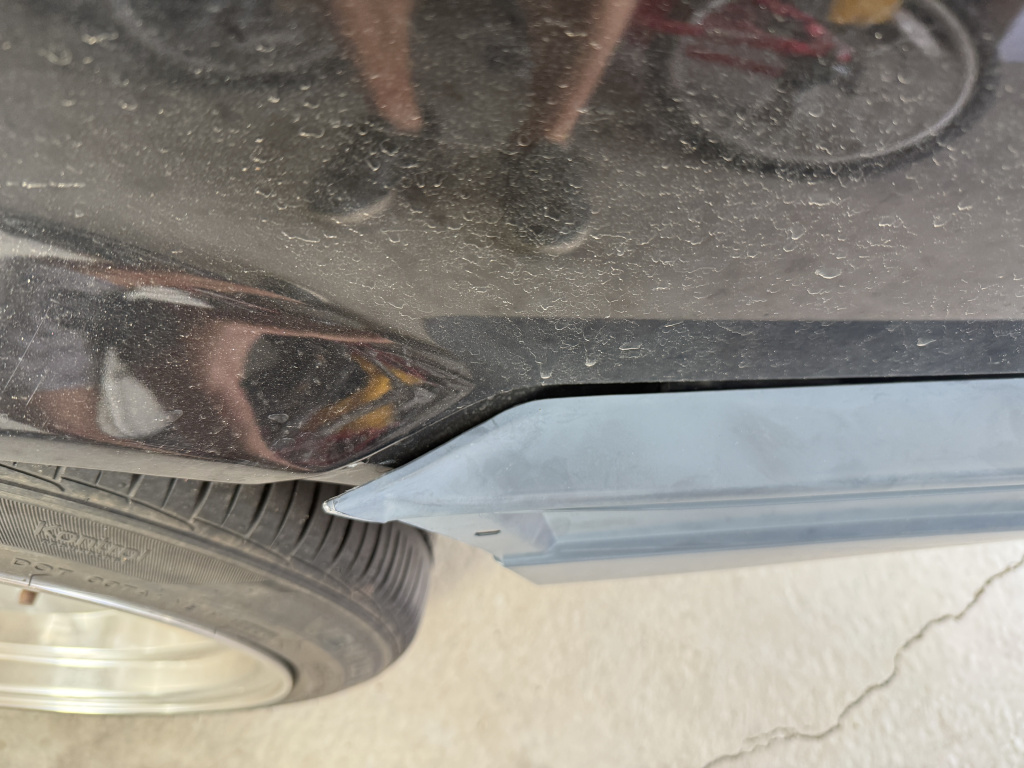

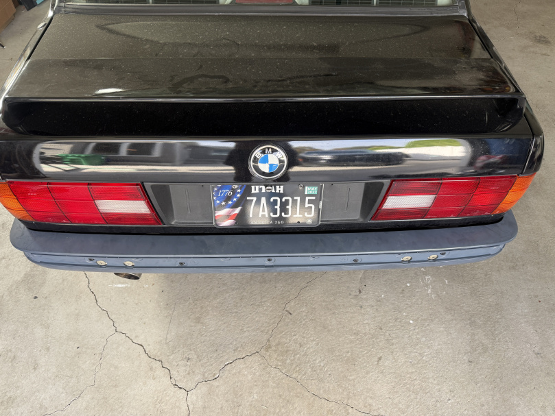

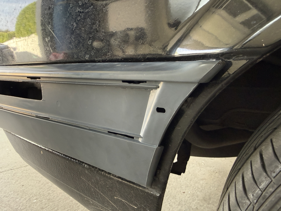

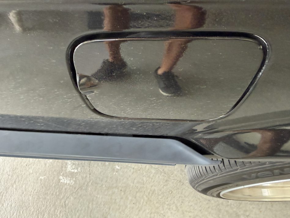

                      And a few more. Click image for larger version
ID:	10166863 Click image for larger version
ID:	10166864 Click image for larger version
ID:	10166865 Click image for larger version
ID:	10166866 Click image for larger version

                        It doesn’t look like the front ends are mated properly to the plastic brackets pictured here
ID:	10166894 can you try removing them from your car and attaching them to the bumper to make sure the can attach properly? Once you’re assured you know how all of the pieces clip together, follow the link guide to reassemble and adjust the position of the front edges.

                          ehrawn's right, and it's the step most people skip: bench-assemble it first. Brackets onto the bumper, off the car, and make sure the front ends actually clip in while you can still see what you're doing. The side not mating to the bracket is almost always that step, not a bad bumper.
                          While it's apart, check these, because the fit fight usually lives in one of them:
                          1. The two side sliders on the quarter panels. Originals are brittle by now, and one missing tab or a worn rail means the front edge never sits right no matter how you shim the beam. They're cheap. Replace tired ones and half the fight ends there.
                          2. Back on with every bolt finger-tight. Nothing snug anywhere. Close the trunk, walk back two steps, look at the top gap. Get it even side to side before a wrench touches anything.
                          3. Torque from the middle out, alternating sides in small steps. One side tight first preloads the other and pulls the whole bumper out of line. Same rule as a valve cover, just bigger.
                          4. Front edges, bumper to quarter: those bracket slots have travel. If it still gaps after everything is loose-aligned, check the beam isn't bent, and be honest about whether the car's ever been bumped back there.
                          If it still fights, post a shot straight down the side with the gap showing, and one of the slider area with the side piece pulled. I'll tell you which way I'd chase it.
                          - Jess (I do body and paint for a living)
