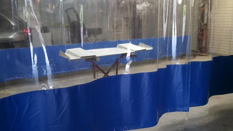

        Pics of the mold, just have to smooth out a couple of corners and its ready to have the CF molded over it.

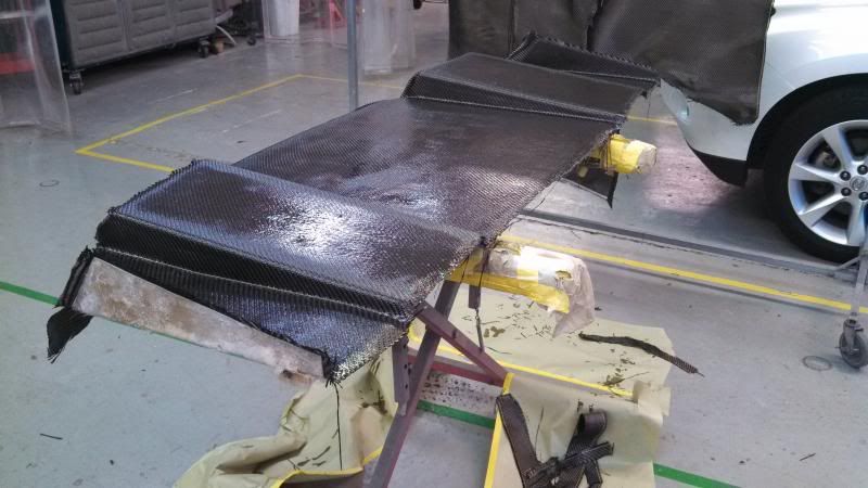

                        Time for some updates...we've been busy this last week and this past weekend we focused on getting our cars ready for autocross this past Sunday. There's also a possible short term post ponement due to a slight mishap...read on.

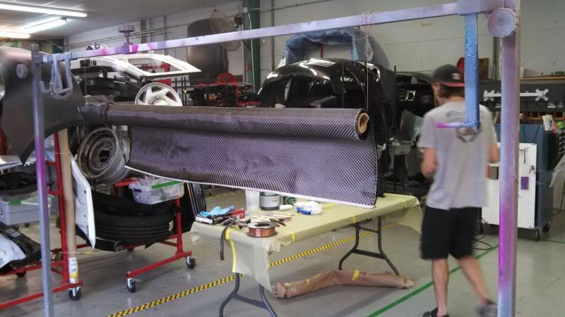

                        Here's the saw material.
                        We finally got the mold sanded and prepped properly and then got it primed and ready to lay the cf material down.

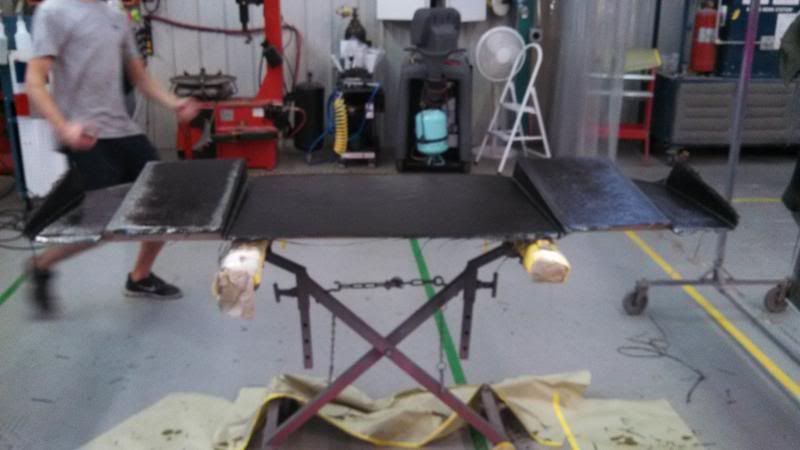

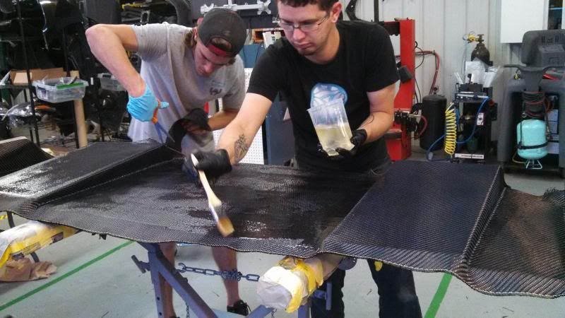

                        Applying the resin
                        Done applying the resin here
                        Cody showing his excitment, LOL

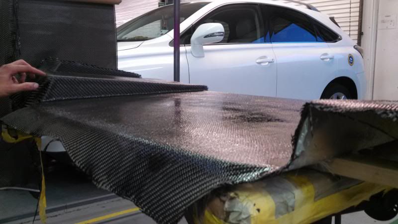

                        And now for the bad news...
                        It was taking forever to dry and stayed tacky for a few days. We put it out in the sun and it made it worse. The resin we used wasn't exactly the best and on top of that, 90% humidity for days on end didn't help.
                        Once Cody popped it off the mold, we discovered a ton of air pockets underneath and the finished piece was flimsy.
                        We're going to make another but use the same resin we used on the fiberglass mold. That dried way quicker and was easier to lay down. Since we don't have enough to make another diffuser, we're going to do my sunroof panel with the remaining.
                        So, in the next few days, we'll be removing my sunroof panel, sanding it down smooth and prepping it for the fiberglass mold.
                        I'll update as we go.

                            #43
                            Yea, it was a bit of a disappointment.
                            We actually decided that we're going to use the vacuum bag method for all future molds to eliminate possible air pockets. Its a little more in materials, so cost may go up a little on parts, but not much.
                                Good to hear you'll be bagging them going forward. I was going to ask why you chose not to do it that way this time. Will you autoclave as well?
