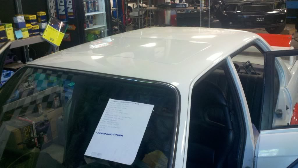

      I have a manual sunroof. The panel alone weighs a good 30lbs. The cf replacement will be roughly 1-3lbs. That and its an alternative to having to replace a rusty panel with another metal one that will most likely do the same thing.

        The factory sunroof panel alone most certainly does NOT weight 30lbs. Id guess 5 to 10 pounds, maybe even a little less.

              The panel is only about 10lbs. the cassette that houses the entire sunroof setup is closer to 30lbs.. I have removed both.

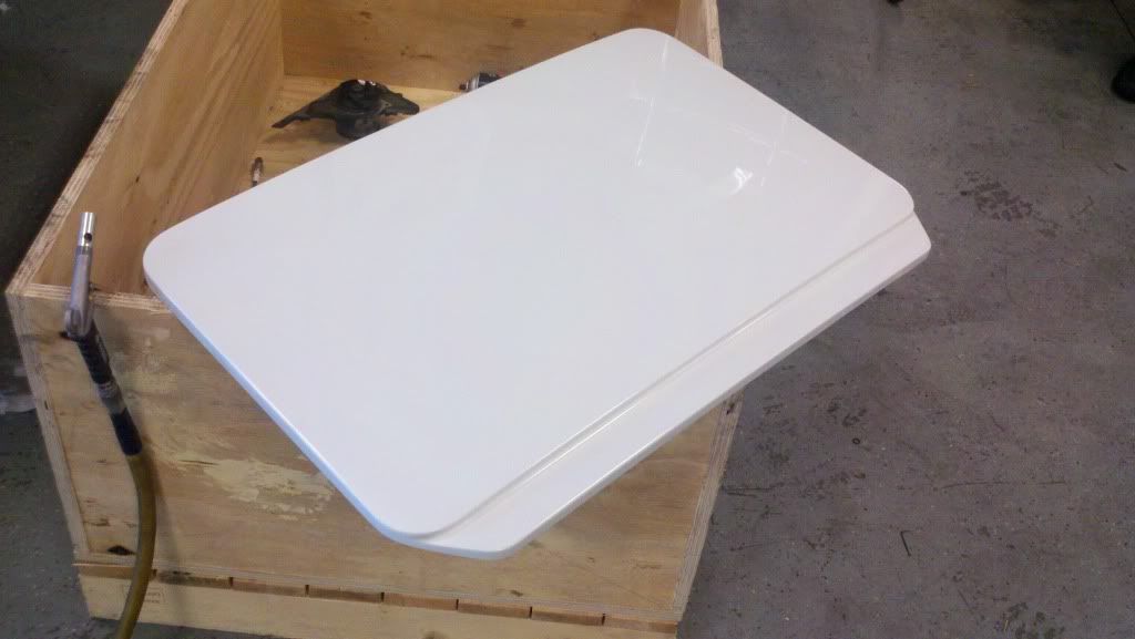

                  Installation of our plug will be similar to that one above.
                  Updates coming tonight. I was gone for a few days so we're just now getting around to making the mold. I'll post progress pics in a few.

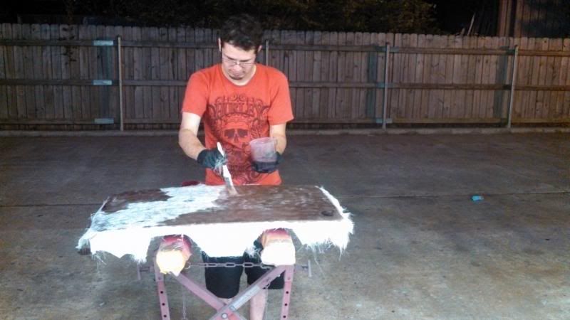

                          In your diffuser attempt, I only see 1 layer of cloth applied, is this correct? You need at least 3 layers for a properly stiff panel. If only one layer of cloth is applied, that is your reason for it not being stiff, especially on a large object like yours.
                          Vacuum bagging will help reduce weight as well as save on the costs of resin as it uses much less resin than a wet layup like your first attempt.

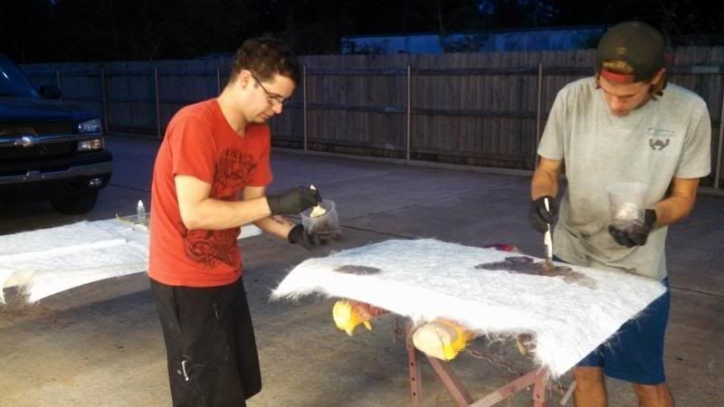

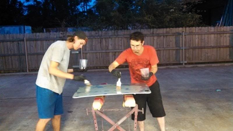

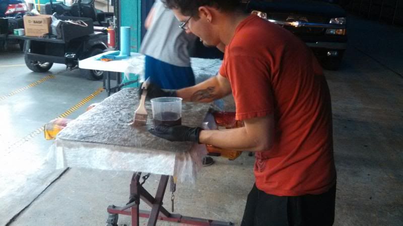

                            For the diffuser, we will be layering it...we thought about it being too thin.
                            Sorry about the late updates...its been a long week already.
                            Also, forgive us for taking a bit on these pieces..we're trying not rush anything, if we're going to be selling these to forum members, we don't want to put our name on anything less then perfect quality!

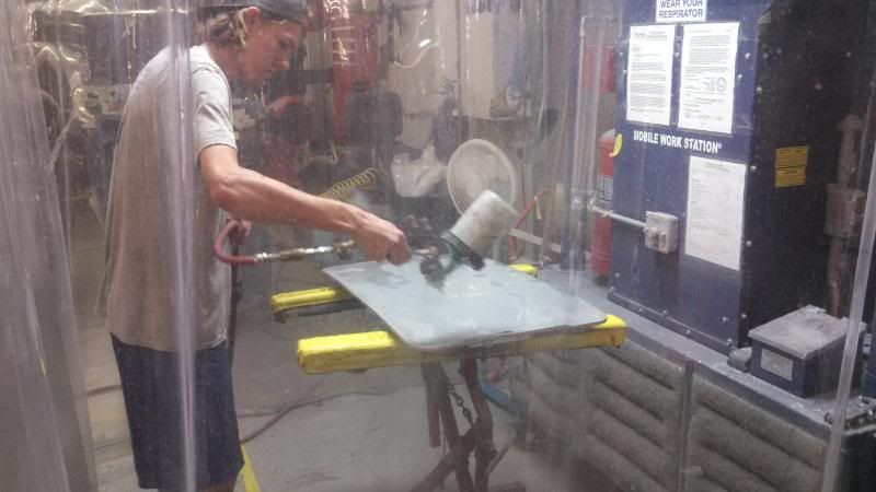

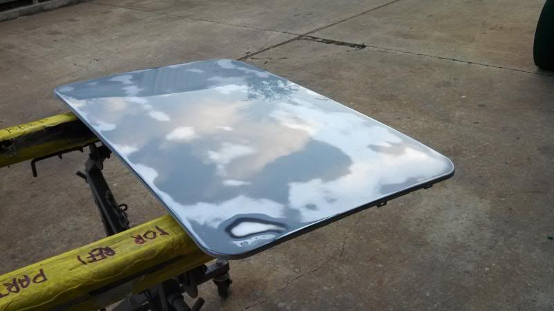

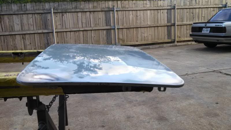

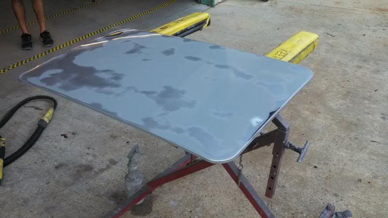

                            Pics:
                            Spraying the release wax...this was after applying release wax in paste form as well.
                            1st layer of resin before the mat
                            2 layers of fiberglass
                            3rd and last layer
