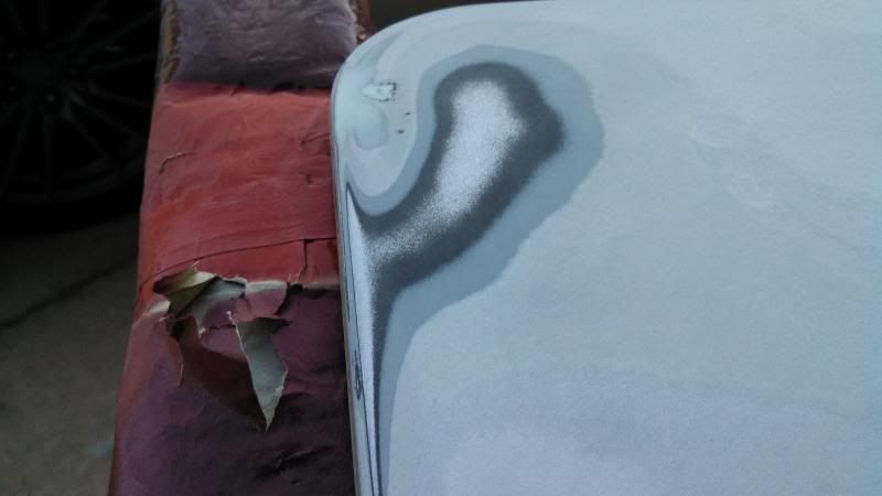

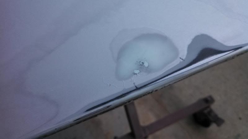

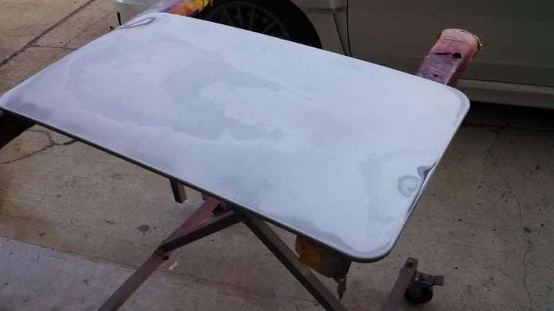

        More updates coming this evening. Since we don't have enough material this batch for another diffuser, we went ahead and pulled the sunroof panel out. I had a couple of tiny rust spots we had to sand and fill. Got it glass smooth and primered. Pics soon

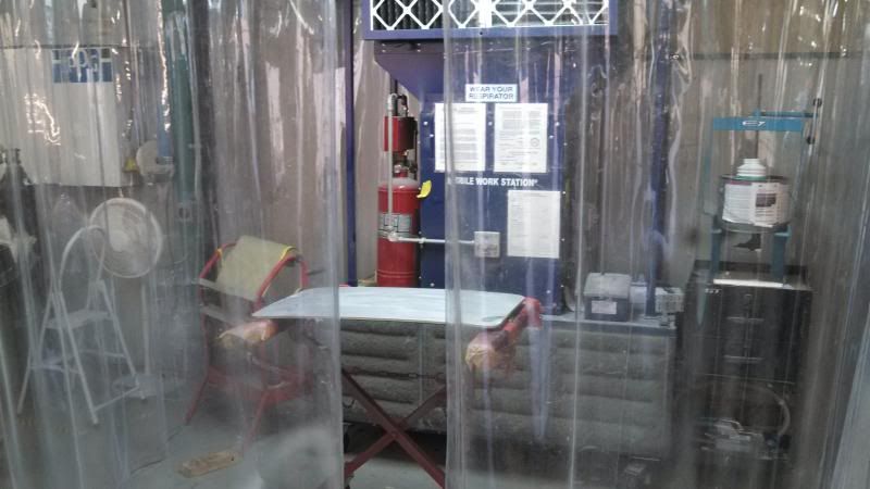

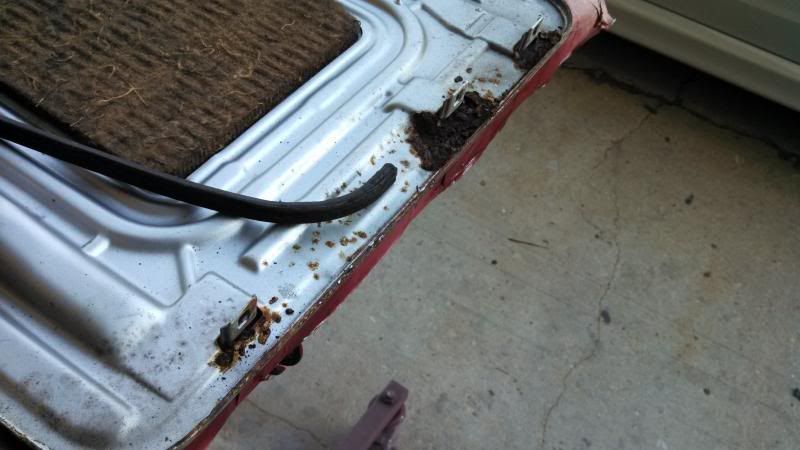

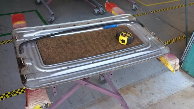

          Ok, sorry for the delay. We had been working late and I never got around to posting pics.
          Everything is on hold till after the 19th. Its going to be raining here all weekend, so the humidity is putting a damper on things. On top of that, I'll be heading to Texas for a few days as of Tuesday. We'll get back to work soon as I get back. I had to order a new sunroof seal anyway, so I have to wait on that as well. I cracked mine while taking it off. My roof is crash wrapped right now, lol. Also discovered a good bit of cancer spots on the under side of the panel.
          Got it smooth and primered...when I get back from my trip, we'll start laying the fiberglass to mold it.
