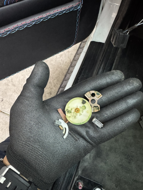

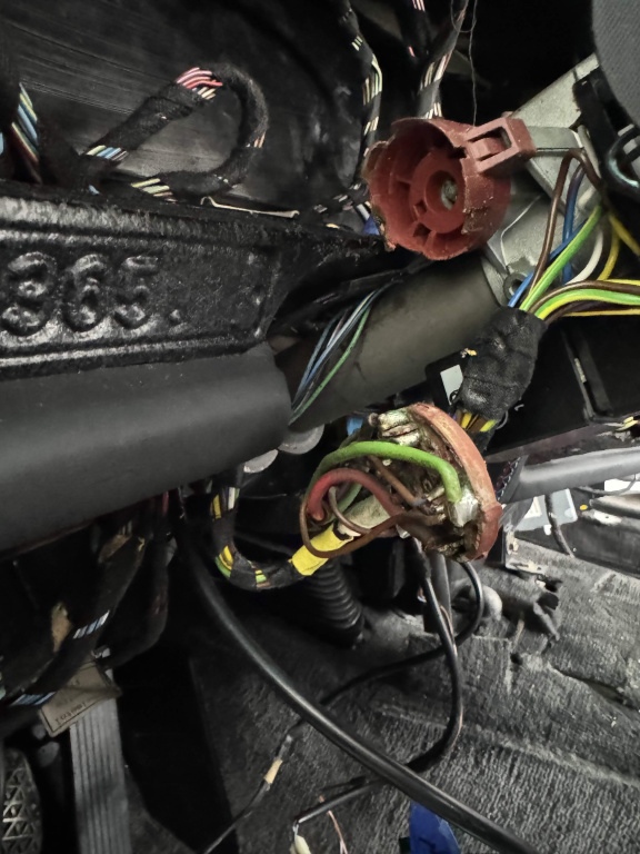

    In the process of replacing my dash. These parts just fell off the left side of the steering column. What are they and how worried should I be?

    Thanks in advance.

    looks like a broken ign switch

      It's the connector for the ignition switch.
      61321374967
      61321377069 (airbag)
