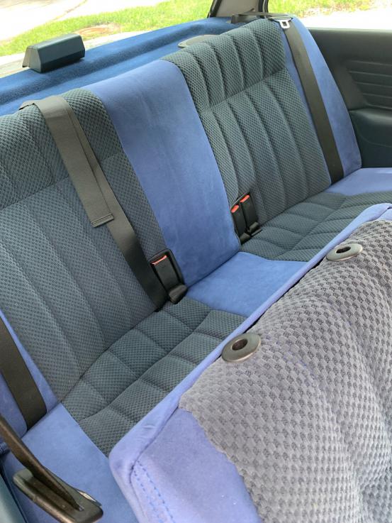

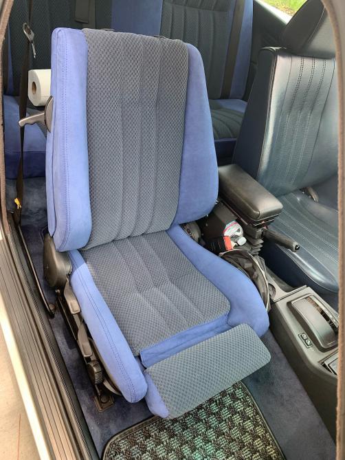

                      Thanks Corey...and I just moved the rails from my comforts on to the newly dont support seats so yes that's a definite Click image for larger version  Name:	E6CC1FC3-3A7B-4410-8738-15BE527CD8A0.jpeg Views:	0 Size:	67.3 KB ID:	10022718 Click image for larger version  Name:	FE033C6C-17B1-4512-8FDC-D08E2B452D35.jpeg Views:	0 Size:	74.1 KB ID:	10022719
                      and yes that's another exceptionally well done Ninestitch set of skins
