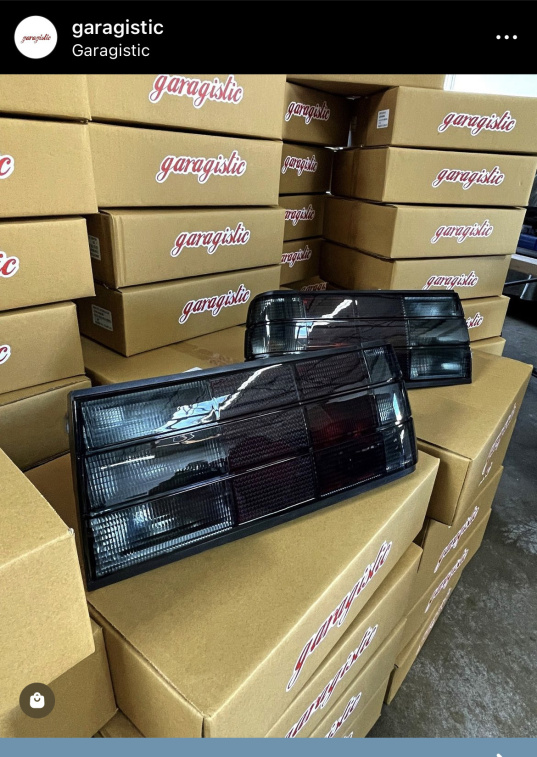

                              I just ordered these . I want to put an amber bulb in it . Would rather not put an LED in it . I hope the amber bulb creates a bit of the egg yoke look in it also . I do have the triple stop light upgrade . I think I showed you last time . My buddy wired it up for me .
