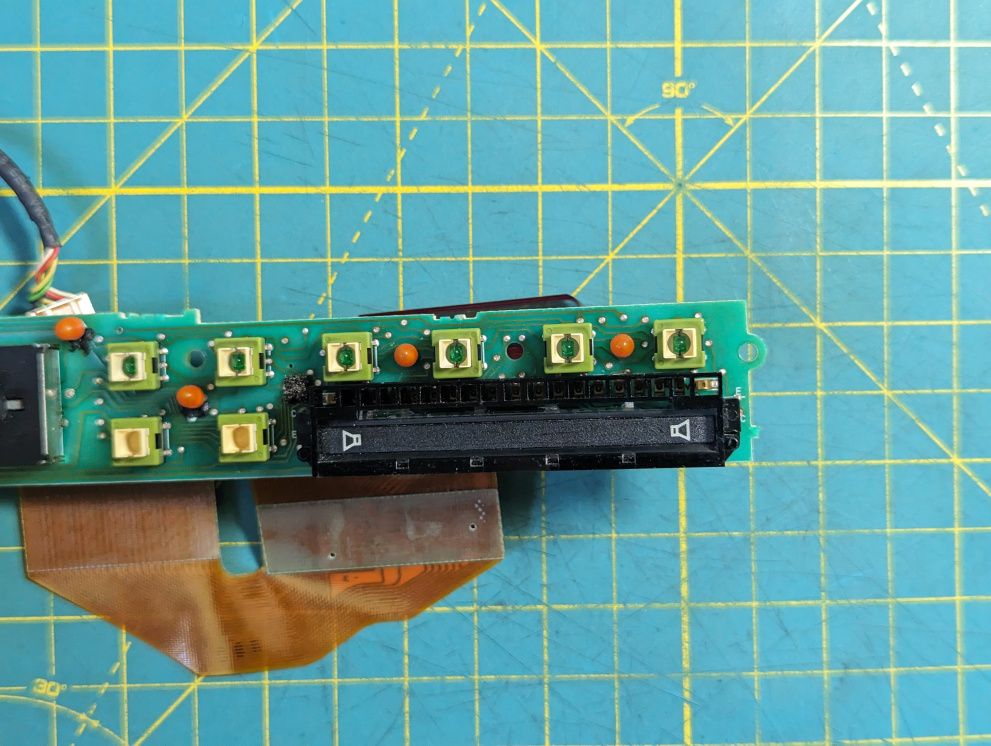

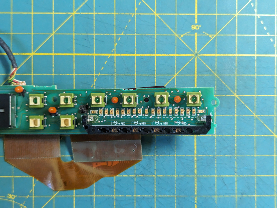

      Some pictures of mine disassembled:
      Click image for larger version  Name:	PXL_20230815_175619546.jpg Views:	0 Size:	272.0 KB ID:	10101749
      Click image for larger version  Name:	PXL_20230815_175945578.jpg Views:	0 Size:	336.1 KB ID:	10101748
      Click image for larger version  Name:	PXL_20230815_175810224.jpg Views:	0 Size:	330.1 KB ID:	10101747
      So I think it uses the 2 clear LEDs (probably IR) send the signal, and then the plastic housing filters it so it shines down on the 4 sensors in the bottom (under the "RED" on the PCB). Then like the above site said when you block the signal to the sensor it does some processing to see which way you are adjusting.
      I tried with my phone camera but not seeing any IR, but tested on a TV remote and you can see it.
      Also testing with the radio it does not register anything when its disassembled. Looks like the way the plastic blocks the light so it only works with the front cover and faceplate assembled.

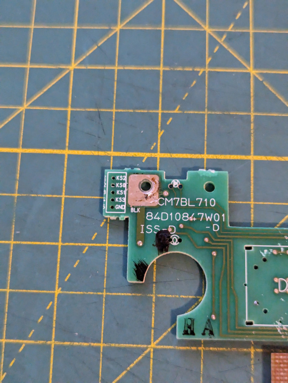

              Thank you bradnic​ for that extra board. I've been poking around at both my original and that one but can't find anything different. I traced the IR receivers and found out they don't use the main ribbon cable, but the separate 5 pin harness on the top left next to the volume rocker, KS0-3 and GND.
              I've tried with my older Fluke multimeter but haven't been able to get any pattern testing resistance, continuity, voltage dc or ac when powered on or off. I've tried testing by covering the sensor with my finger while also probing both ends. Probably going to table this for now as it seems like I need some oscilloscope and better circuit tracing skills to see where it goes beyond the plug on the mainboard. This is all a bit beyond my skills for now but hopefully this helps someone else who knows what they're doing and can pick up from here.
