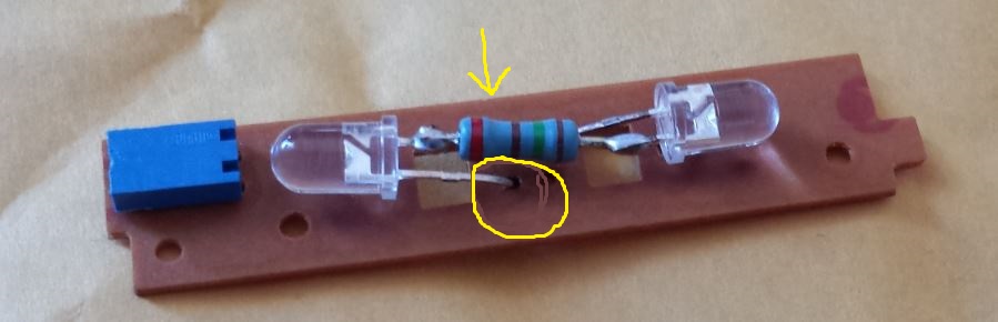

                  EuroCCA link is dead. I have completed two of these bars per the link below and neither works. Any help?
                  • KingJaffeJoffer
                    • Jan 2016
                    • 25

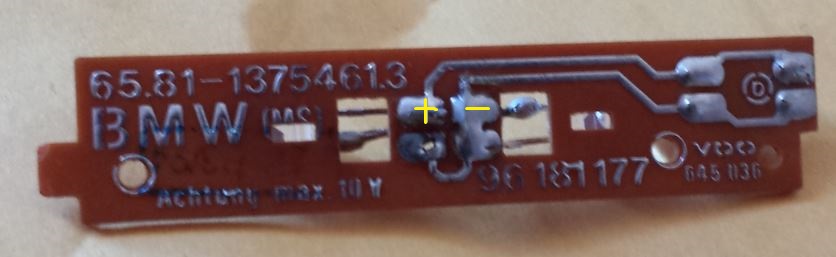

                    Figured it out: wiring in the RTS link above bridges the negative leads. I did not bridge, but instead soldered the cathode lead into the hole hidden under the resistor, so that the anode (+) and cathode (-) leads in the second pic are soldered as marked (without the bridge). Same result.
                    • chicaneS54
                      • Oct 2022
                      • 14
                      Agreed RTS is a horrible write up and did not cover the bridging of the negative side.
