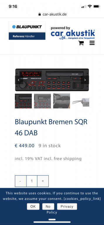

    Much more expensive, but also kind of perfect. Blaupunkt brought back the Bremen headunit from 1986 that looks nearly identical but has been modernized.
    I’ll probably be using this in my current project
    Here’s the link for more photos and information.

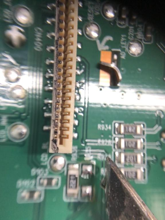

                                Here's a radio I'm working on. Pictures are a little blurry, phone was refusing to focus correctly. The bias resistors are relatively easy to adjust, they are big SMT parts, you flow extra solder onto each end, and heat each end up simultaneously if your tip allows it. If not, then you heat up one end, heat up the other, and go back and forth until the part is floating, then flick it off with your iron.
                                It's the same process for the LEDs, but they are much smaller and harder to reach. I can't really photograph adding new LEDs, too small to handle and photograph, but I can show removing one. It's the same process as the resistor though, just scaled down.
                                Bias Resistors for display backlight:

                                Heating up the pads:
                                Click image for larger version  Name:	IMG_0545.JPG Views:	0 Size:	50.1 KB ID:	9951345
                                Lifting the part off with my iron, just using surface tension to lift it, it's stuck to my iron, a little hard to see:
                                Click image for larger version  Name:	IMG_0546.JPG Views:	0 Size:	51.0 KB ID:	9951346
                                Cleaning the pads with solder braid:
                                Click image for larger version  Name:	IMG_0547.JPG Views:	0 Size:	58.2 KB ID:	9951347
