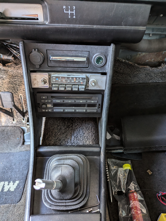

            Excellent post you started bradnic! I need to finally finish a complete E30 1989 325is audio system install into my 1971 BMW 2002 (50 year ownership) that I started 2 decades ago. The only upgrade is a CD43 head unit. The problem I have is audio clipping especially when playing a high quallity CD. I have tested 3 different OE audio amps with no change. I will locate another CD43 to test but maybe the CD43 is over powering the OE speaker/tweeters? PS I am working on some custom from kick panel mounts for the front speakers.
              The CD43 was an E36 area radio that worked with a different power amplifier than what was used in the E30. It definitely produces about double the power than the E30 radios did, so you are probably correct that it is overloading the amplifier. I recommend you run an E36 amplifier or run the radio without an amplifier.
              This post about the CD43 is excellent

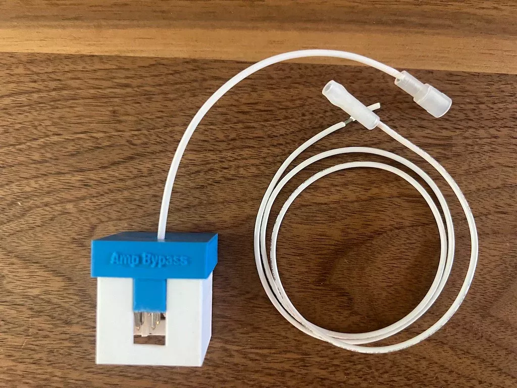

                        STEP 1: IMPORTANT: verify your radio can work with common ground radio output ground wiring.
                        If it is not compatible then trying to use a common ground setup will lead to reduced power output and overheating. The workaround here is to use my OEM front harness replacements to get individual radio output grounds for the front channels without cutting your factory wiring.
                        Here's an E36 Sound System ETM diagram - you can very clearly see individual radio output grounds going to the trunk amplifier (lower right, BR/OR [brown / orange] wires between the radio and amplifier). With the exception of radio only 318is wiring, the E30 Sound System setup is *NOT* like this.
                        STEP 2: Plug in one of my amp bypass adapters in the trunk amp harness connector
                        Click image for larger version  Name:	amp bypass adapter.jpg.webp Views:	0 Size:	139.2 KB ID:	10138873

                        The 'classic' cut amp bypass speaker grounds *are* connected to the radio output grounds. See the first post for more details. This is why you need to be certain the radio will work with common output ground wiring.
                        The Sound System front wiring kit with individual radio output grounds I mentioned above comes with a different version of the bypass adapter in the pic above.

                                Additionally, do the front Speakers & Tweeters have to be re-wired and if so, do you offer a pre-made wiring kit for that purpose?
                                Yes I certainly do. The wiring products are all based on the idea that you DON'T EVER CUT FACTORY WIRING. I'm constantly tweaking the products though as I engage with customers - there are alot of combinations to deal with depending on the original wiring, radio being run, amp config etc.
                                In your case, you need to convert a late model E30 sound system setup to a radio only install and a 17 pin radio connector. If you want to add something like a powered footwell sub there's an option for that too, as well as wiring adapters for component speakers should you want to head that route.
