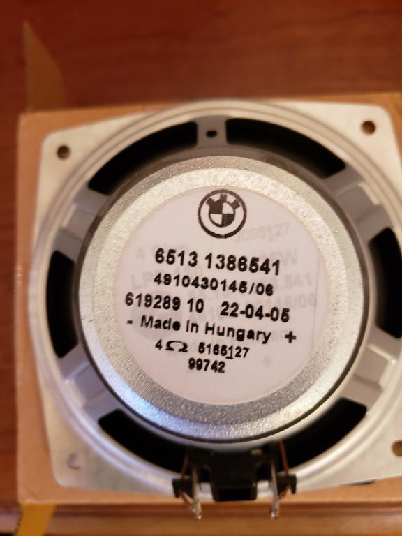

                    Looking at photos:
                    65 13 1 386 541 - NOT REAR PREMIUM SOUND
                    65 13 1 370 834 - NOT REAR PREMIUM SOUND
                    65 13 1 377 775 - Old premium sound P/N found on Front and Rear speakers?
                    65 13 1 386 546 - New Premium sound P/N found on Front and Rear speakers?
                    According to photos it looks like this is same speaker front and rear.
                    roguetoaster had the correct P.N.
                    @Zakspeed_US
                    • rturbo 930
                      • Dec 2005
                      • 2627
                      Well that explains why mine looks different. Figured it was just an updated design, since the one I found was supposed to be a superceded p/n. Guess I'll have to do a return lol.

                            Here's the non-premium speaker for comparison - not made in Germany.
