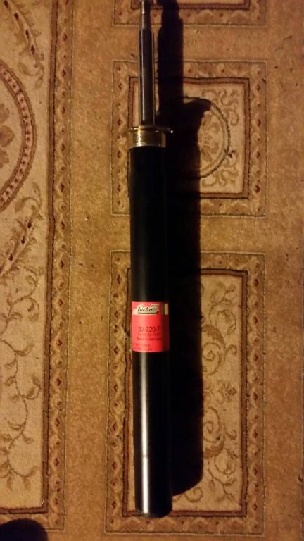

            I have two oem front shock brand new Click image for larger version
ID:	7184840 PM ME THEY FOR SALE

              Sorry. Bought new Sachs shocks. It was more a curiosity about completeness of PO service records

                The OE shocks were yellow, inverted, and had a BMW logo engraved on them. I actually did take the original inserts out of my first e30, and I think I may still have them floating around the shop shelves somewhere.

                          I have an 86 with 360k miles with records up to 340k (working odometer obviously). They definitely are not OEM inserts since the OEM were yellow, inverted monotube (like the Bilstein HD/Sport) with the BMW logo engraved on it, as per my previous post. My first e30 had original inserts that I changed at 74k miles.

                              My 91 325is shocks are black. Car has 30k miles and never been replaced. Red would prob be Koni replacements.
