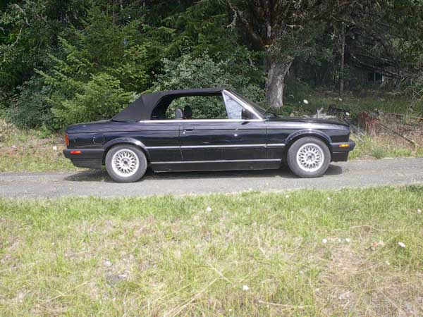

                aboout 3/4 to n inch drop.
                Not the best before and after pic but here it is. I think would be a great set up for a 325 instead of 318. I thinking of cutting a coil in the front...
                Before pic is with the top up
                After pic is with the top down
                        How do you feel about the shocks? Satisfied?
