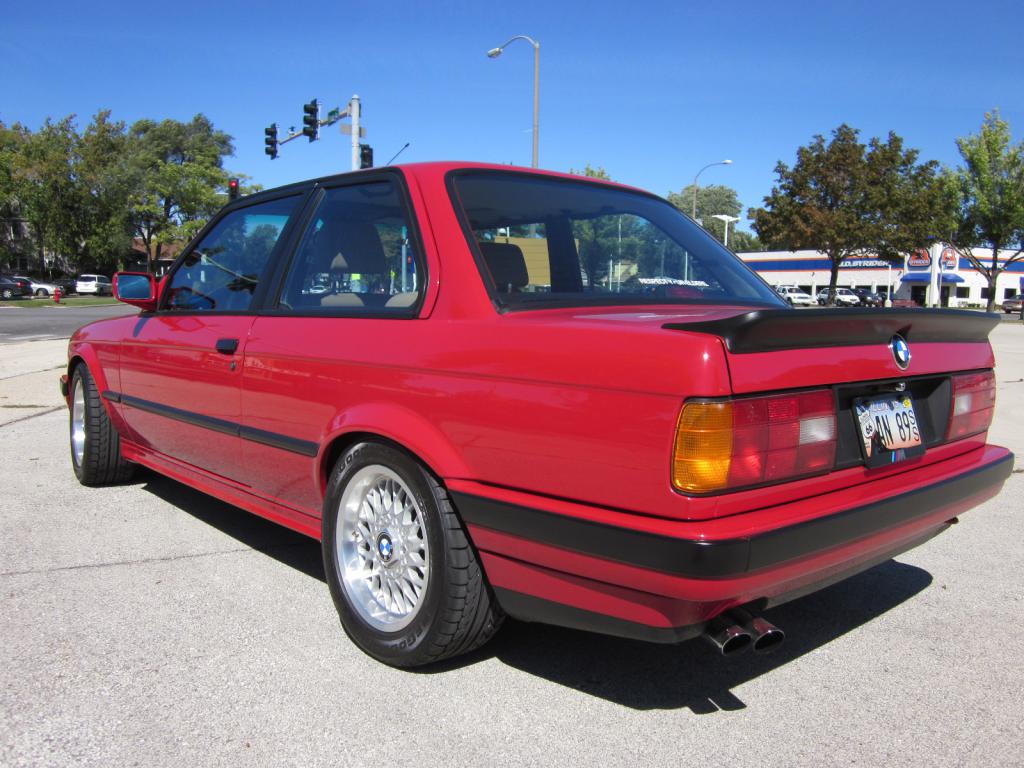

I had my trim powder coated also and I have to say it looks so factory you'd think someone went all budget-be-damned and bought brand new shadowline trim. This does of course mean removing the trim, but it's NOT THAT DIFFICULT. Just make sure you use the small nylon prybars (you can pickup a set at HF for $8 I think), be patient and take your time, and start from the underside of the trim and pull out and up--I repeat, pull out, and up--over the rain gutter a small area at a time. You'll see once you pop your cherry on the first one.
Oh, and DO NOT take a screwdriver anywhere near this trim.
If you decide to paint in situ instead and disregard everyone who says to powder coat, well it's still gonna be a bitch to mask off the trim, sand, primer and topcoat. Save up 100 clams and powder coat it. You will thank me later.Last edited by TrentW; 10-04-2018, 08:42 AM.Comment
