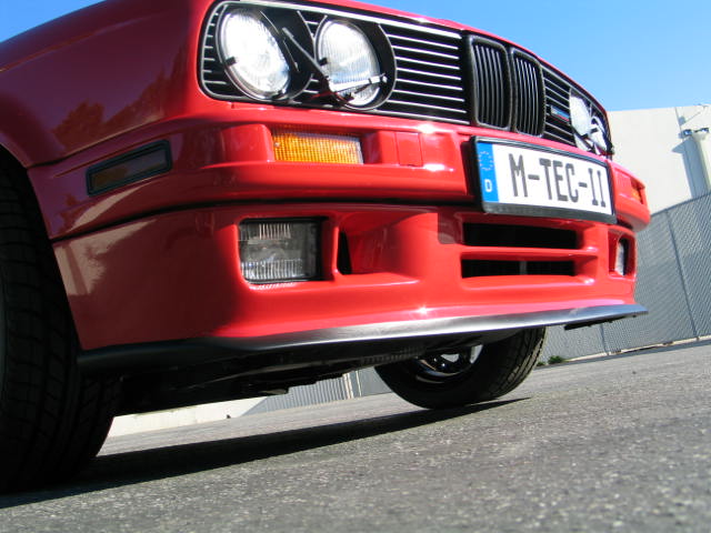

      Originally posted by carmv4
      what lip is this? looks good!
      • e30s52
        • Oct 2007
        • 5235
        #63
        /\ oem e36.
        www.gutenparts.com
        • der affe
          Technical
          • Dec 2005
          • 8452
          #64
          number 23?
          http://www.realoem.com/bmw/showparts...58&hg=51&fg=15
          seien Sie größer, als Sie erscheinen
          • e30s52
            • Oct 2007
            • 5235
            #65
            /\ Yes I think so. Its that or the e36 M one I cant rememeber.
            www.gutenparts.com
            • cactusjacks1
              • Sep 2004
              • 1216
              #66
              Not sure - but not an oem piece & not the E36 one. The E36 needs lots of mods (narrowed, & change the bends on the ends) & the ends are much different than the one shown. This is probably an aftermarket piece made for the M-Tech valance.
              The E36 M was the basis for making the mold for this one.
              [I
              • e30s52
                • Oct 2007
                • 5235
                #67
                It is an oem e36 m3 lip. Here is the link.
                www.gutenparts.com
                      As you can tell I haven't been in this thread in forever. I believe the lip is an m-tech bit. The PO put it on the car just before I bought it. If you want to know what kind of lip it is pm zimmie.

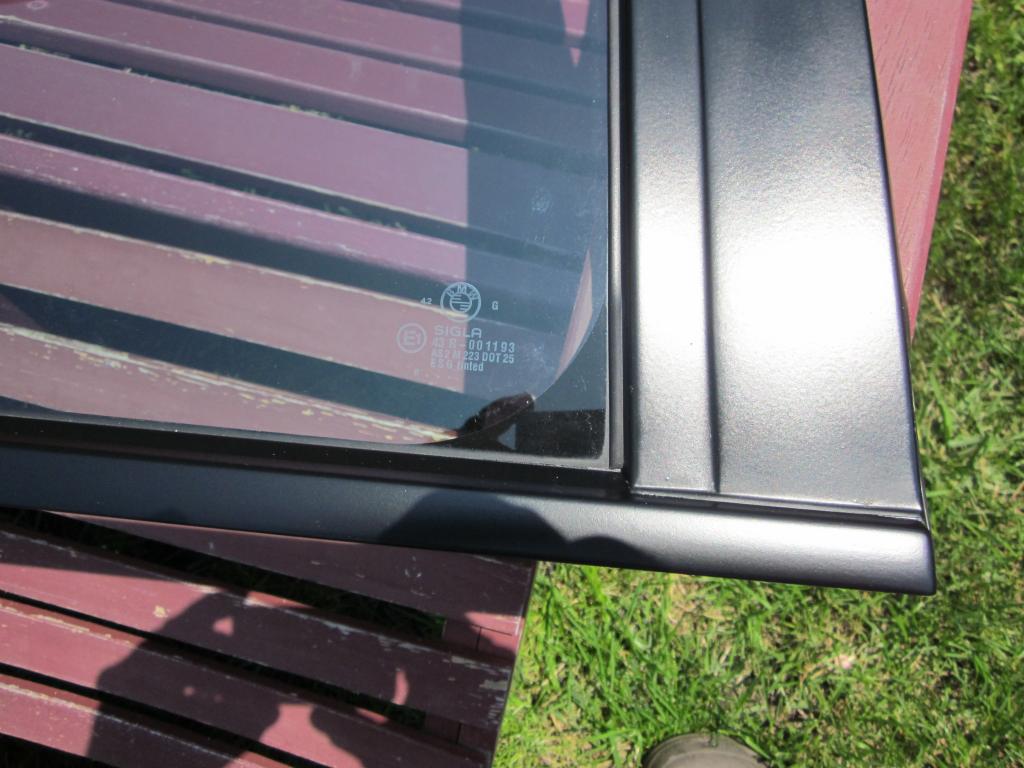

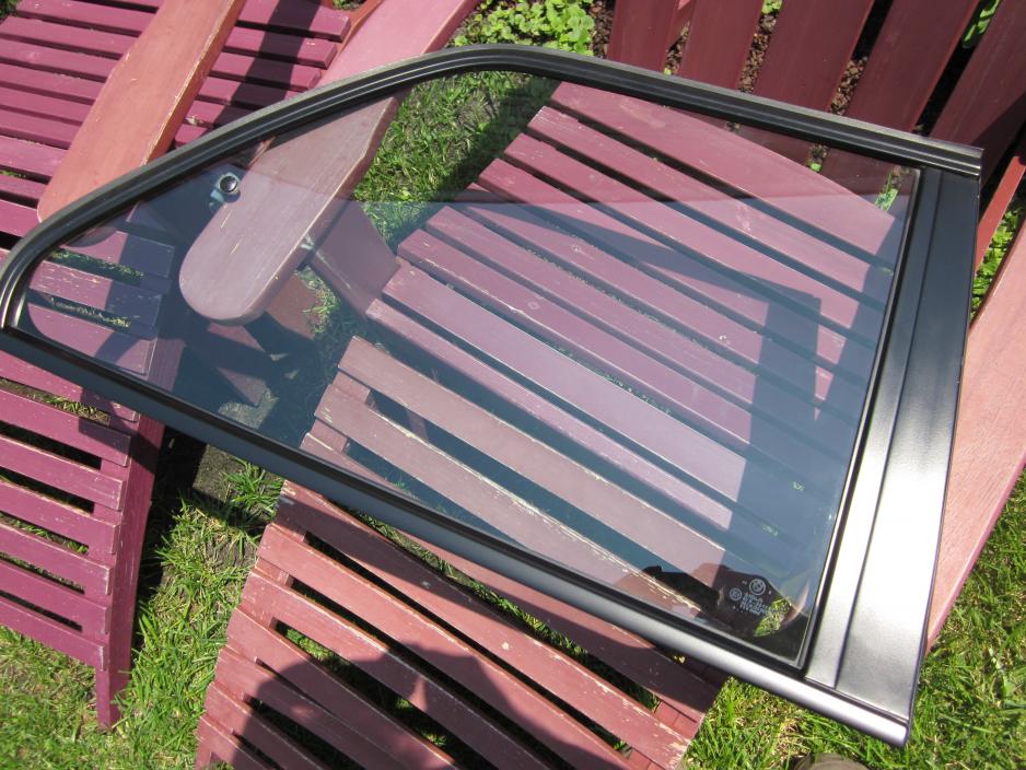

                              As others have mentioned, Duplicolor Trim Paint is the best match to the original satin paint. I actually took my trim off and had it powdercoated since I was having my car painted, but the rear quarter window lower pieces don't come off, so I decided to paint them to match. Didn't paint the rest of the frame, just the lower piece. Sanded the etching primer after the last coat and then sanded the trim paint just before the last coat. You can't tell the difference.
