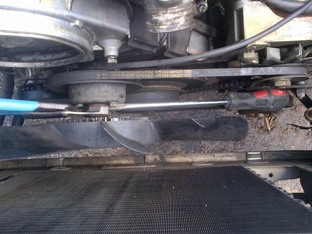

          Some say this is impossible but it does exactly what the "pulley tool"does although with a little less certainty. I've never needed more than a tug or a sharp whap with a hand held tool to get a fan off.
          Just make sure the screwdriver is set against the PS pump, that the wp pulley is rotated clockwise to "lock down" the screwdriver and that you are pulling up so if something slips your knuckles remain attached to your hands :-)
          Note that the tip of the screwdriver is above the fan nut

            Im doing this right now and i cant get that fan clutch loose!! Everytime i whack it, it just moves all the belts i tried wedging the screwdriver in ther and its not budging
              Can someone please help me out??????
              do it when the engine is cold. its left hand threaded. Ive never had a issue taking mine off.

                Engine is cold, been sitting on he driveway for a month. And i know its a LH thread still nothing. The pulley isn't suppose to turn with it corrct?
                  Thats like trying to unscrew a bottle cap without holding the bottle

                    Yea I know, just wanting to make sure. I've never actually worked on cars until now and I'm learning as I go. Bought the pulley holder from ebay so will work from there. Just a noob trying to learn that's all :)
