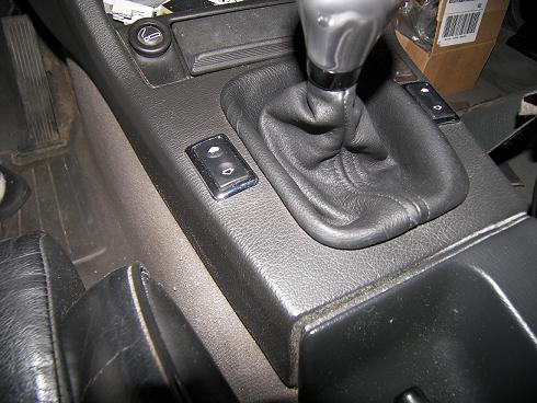

Sorry, I will take a pic today. I used/made push connectors. It was WICKED easy. :)'89 "is" = M technic II build mode.

so if I understand this correct
e36 pins = e30 wires
PIN 1 = BROWN 1
PIN 4 = BLACK
PIN 5 = GREEN / GRAY
PIN 6 = BROWN 2
PIN 8 = PURPLE

Oh man - I let me go read my pins. This time I will bring a flash light....'89 "is" = M technic II build mode.

PIN 1 = BROWN 1
PIN 3 = PURPLE
PIN 4 = BLACK
PIN 6 = BROWN 2
My 8 is really a 3...sorry about that. I have corrected my post.'89 "is" = M technic II build mode.
sigpicComment
IT WORKS here what I did
PIN 1 = BROWN 1 =4
PIN 3 = PURPLE = 8
PIN 4 = BLACK = 1
PIN 5 = GREEN / GRAY =3
PIN 6 = BROWN 2= 5
* BOLD are e30 switch

thanks again guys i will finish this mod tonight or this weekend thanks VAPORBLADE and others for helping me out .
