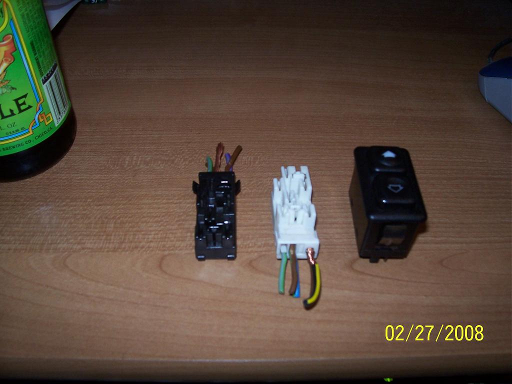

              this retro fit is getting rediculous. I have two white base switches for my front windows and they work fine.
              For the rear windows I had to go with the blue base switches.
              Here's the problem: the rear e30 harness' are a little different. They have a different colored wires coming out of the base, but the socket/pin numbers are the same as the front so i didnt think it would be an issue. I used this to wire them up:
              e36 e30 wire F e30 wire R e30 socket
              PIN 1 = BROWN 1 = brown 4
              PIN 3 = PURPLE = black/yel 8
              PIN 4 = BLACK = blue/gre 1
              PIN 5 = GREEN / GRAY = green/gra 3
              PIN 6 = BROWN 2= brown 5
              All that happens is that I blow a fuse. I have tried switchin the browns as well. Any help here? Thanks
                AARON LOOK
                PIN 1 = brown
                PIN 3 = black
                PIN 4 = purple
                PIN 5 = green
                PIN 6 = brown

                      #235
                      Originally posted by franco90
                      AARON LOOK
                      PIN 1 = brown
                      PIN 3 = black
                      PIN 4 = purple
                      PIN 5 = green
                      PIN 6 = brown
                      Yea I got that, but like i said my wires are different colors for the rear switches. So i copied the socket locations from front to back, and I blow fuses. Besides the above is different than what you put on page 12

                          #237
                          Here is what my switch harness' look like. The front is black the rear is white. The e30 switch is placed next to the harness as it sits on them.
                          as you can see it is different from what you guys have. For example I dont have a purple wire. Never the less i tried to match up the socket locations regardless of wire color. That didnt work.

                                #240
                                even if the colors of the wires are different, if you use the pin # and lay outs, it will work the same
