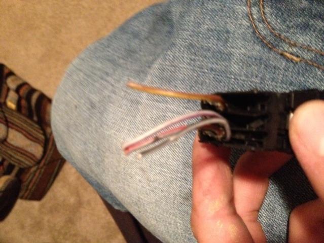

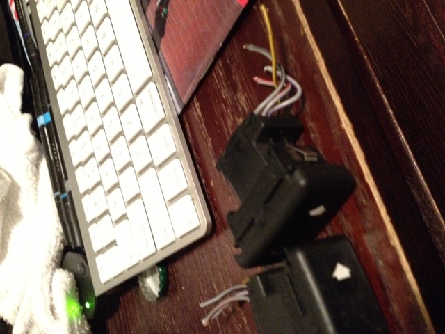

      4 wires instead of 5
      will these switches work? i noticed it only has 4 wires instead of 5.

        ^ Those are not e36 window switches. They are from an e34. They should work if you wire them up correctly.
          Probably not. If I'm not mistaken, regardless of the chassis, the ones with the small bases like that are for one-touch windows, and will not function properly/at all without the main one-touch module.

            they actually are from an e36 from the rear doors off of a 318i. .. :up:
            i guess ill have to go to the junkyard and take the front window switches instead.. (just a pain in the ass compared to taking them out the back)
