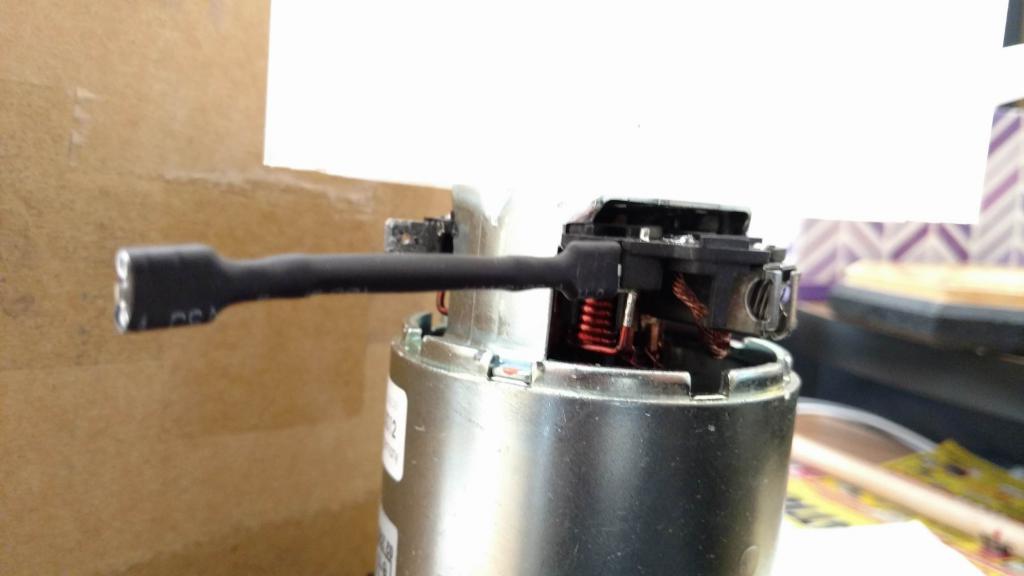

                      Cool. I got the ACM for $223 with tax from Pelican, who apparently had to source from WorldPac. Otherwise it would have been $25 cheaper. I used to have access to WorldPac through a friend. That was nice.
                      The ACM comes with a pigtail on one of the electrical connections (both male), which you need to convert it to female, like the original motor had.

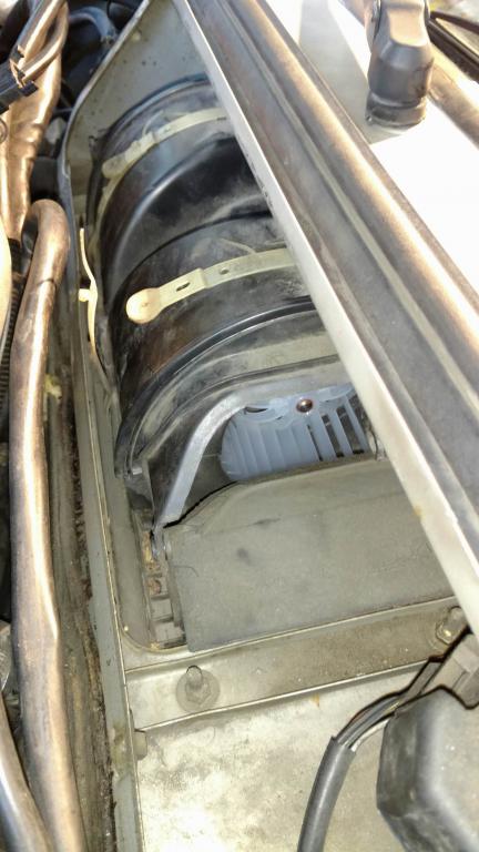

                      Did the job yesterday. One thing I would have done differently is to have tied up the metal clamp straight away (like I've seen here https://www.youtube.com/watch?v=0PyjOwnZH8o), in order to see where it goes. I let it fall out of where-ever it clips at the back of the motor and assumed it went where there is a metal strip riveted in. Well, I didn't have enough slack to clip the motor in when I got it all together, so I had to pull it out and put it back a couple of times to figure it out. Didn't get any pics, sorry. Otherwise it was straight forward and not too much of a pain. I have an ETA and seems like there's more stuff in the way with the cold start valve and mount for flywheel sensors on the valve cover. Just more stuff to take apart and tie up.
                      Also discovered that one of my fresh air/recirc flaps isn't working. You can see them on the sides of the fan housing once the firewall panel is off. By the time I figured that out, I was done with the motor and couldn't see taking it back apart. Isn't there a little motor under the dash for that, IIRC? I just left it closed manually.
