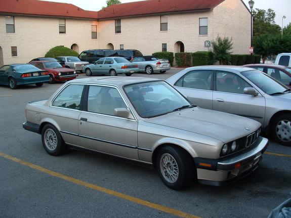

                Yeah, you're wrong. I have a set of 88s on my 87, and it brings them in @ 1/2-3/4 of an inch. It looks much better than total compression.

                  For reference:
                  Mine is the black one ;)
                  Not Totally tucked like a high school kid's car, but tucked enough.
                  And another
