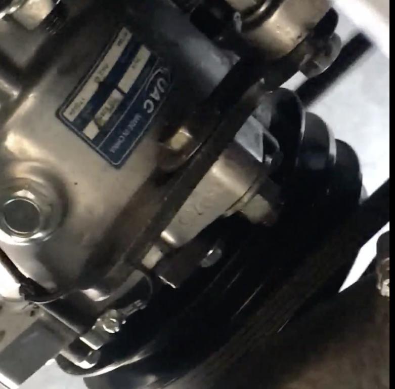

          • bellerto
            • May 2018
            • 51
            #500
            Originally posted by parkerbink
            It's hard to see but the compressor seems to have a wobble. Do I need to contact the seller?
            Because it's a video it won't let me do anything but post the link. Sorry
            https://www.flickr.com/photos/946846...posted-public/
            Hi there. I was looking at your video and trying to figure out the parts needed to mount this on the M20 engine.
            I believe the black brackets on the screenshot attached are needed and I can probably fabricate these myself. But I was wondering if this is mounted to the OEM bracket that attaches to the engine block listed here: https://www.ecstuning.com/b-genuine-...t/64521717007/
            Any chance you can confirm that is what you are using with the SD508 or post a picture of what you have? EDIT: Actually, this looks like the Sanden bracket on this post: https://www.r3vlimited.com/board/sho...d.php?t=358611 that is not easy to find.
            Thanks.
