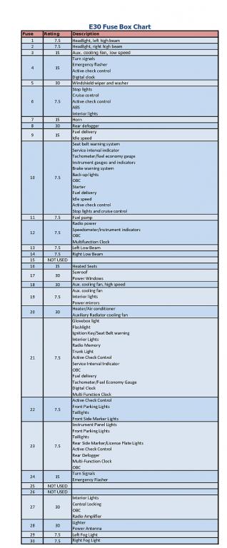

      is there a difference between the us spec and euro spec fuse boxes?
      my euro 323i has a 15 amp fuse for number 11 and also has a 15 amp fuse for number 15
      and my interior lights still work when i remove fuse 27...
      im so lost...
      bump for question needing to be answered. Friend got a 1984 320i and most are the same but every fuse is filled and K9 is fused as well.

          Originally posted by GunMetalGrey
          so the k9 slot is supposed to be empty on my e30 318i?
          Is your 318i a 91? because if it is, then fuse 9 is just power to the diagnostic plug. The later e30's have different wiring.
          this page has most of the wiring diagrams. And yes, each year is a little different....

              bump, because even if a circuit wasn't used, it was often populated with a fuse or relay.
              Example- 87 eta with no a/c still has the low and high speed fan relays installed....
              ...even though there was no electric fan!

                    I had some spare time and thought this would help people read the diagram a bit more easily. Attached is the png as well.
                              Hey I'll answer this 3 years later
                              K9 is used in Europe for rear fogs. If you look in the fuse block on a US car that position has no pins/wires to connect to.
