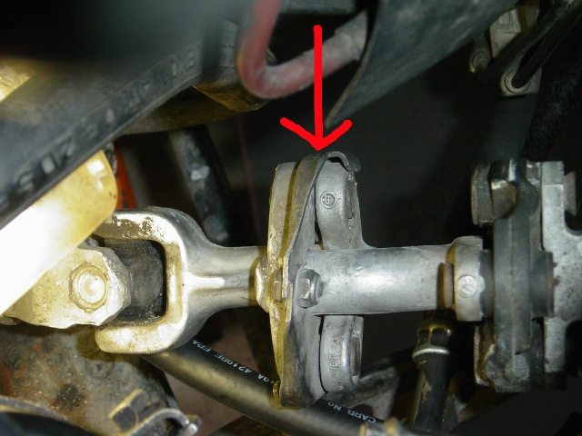

                              Just to add some more noise to this ongoing and really valuable thread - Our stock rack seals are failing, so it's time to do the E36 swap now. Good reference here to counter the heresay about which rack is which…
                              I have a serious question about the collapsibility that was designed in to the stock steering linkage. I've posted some questions before in the steering section about our odd-looking hardware, which I've found was because of an earlier recall for safety. As the linkage shears off the rivets in a front end crash, these steel plates keep the ends of the shaft aligned so you still have some steering.

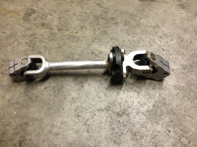

                              The newer (replacement?) linkage has those long studs on it, which I assume does the same thing - the pieces slide down those studs, but are still aligned so you can steer.

                              A guy WAY back in this thread mentioned trying to use plastic nuts or some solution on the linkage spacers so they'd shear off in an accident. I don't know the result of his experiment.
                              All the aftermarket linkage kits are pretty clear that they're "track only" pieces for liability reasons, and say you should be wearing a harness so you don't hit the wheel. For a street-only car, that doesn't seem like a decent solution. My kids will be driving this car.

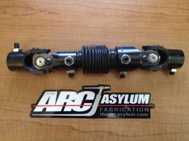

                              These guys have a telescoping center sleeve, but they say the same - track only.

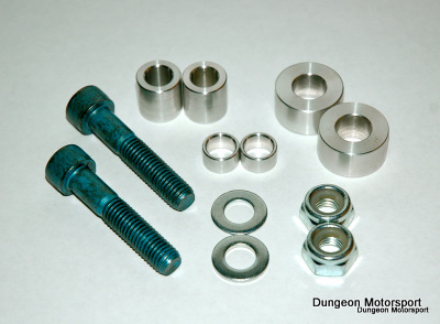

                              chrisnxl185's solution of taking out the giubo and bolting the two halves together with a heavy washer leaves the shear hardware intact, but is a more rigid connection. Others have said that rubber giubo is just for noise isolation and not to worry about it.
                              I'd like to use the Dungeon spacer kit.
