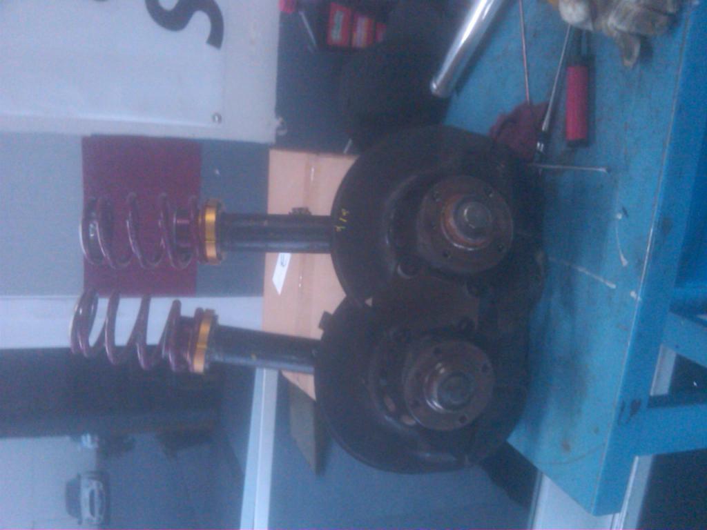

                    Just got my Done today

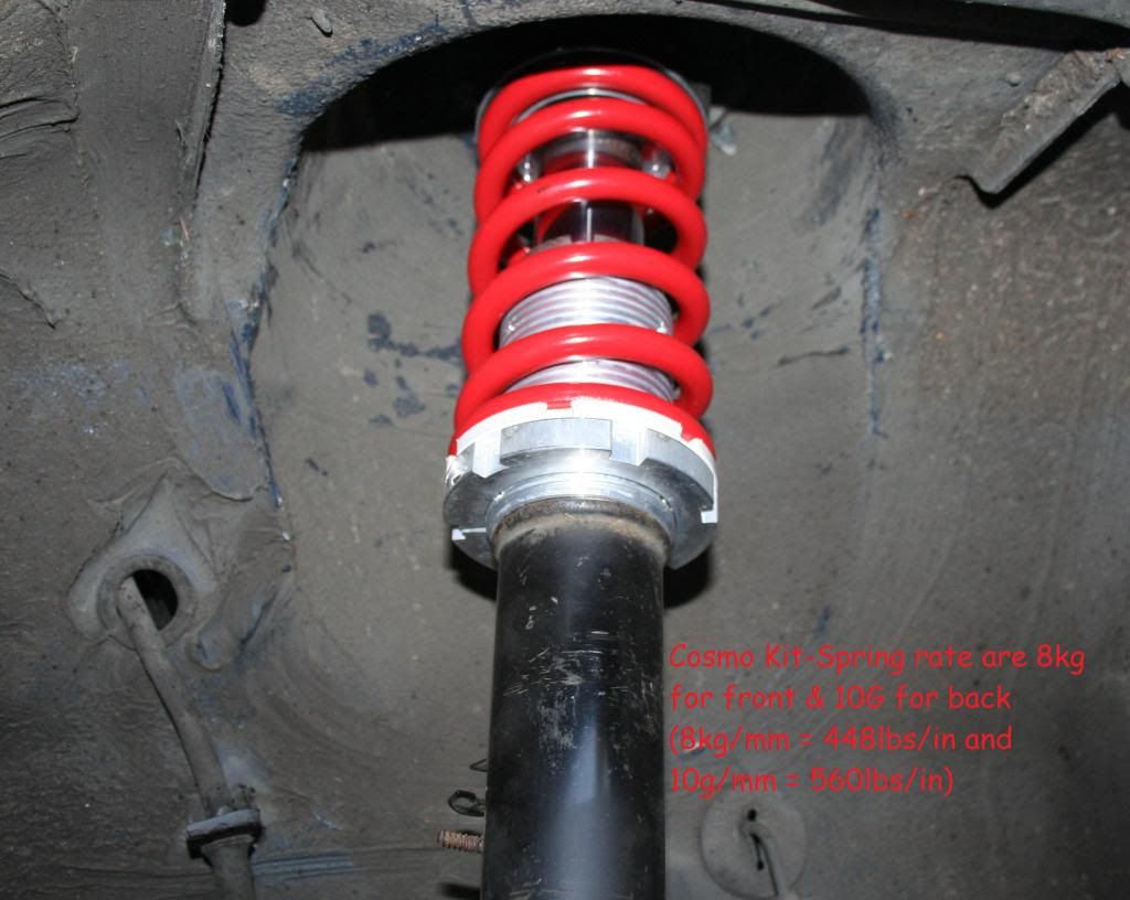

                      i didnt know cosmo made a kit, i guess i never looked
                      did u ask for those spring rates or is that what it comes with?
                      E30 LS1 swap, Tremec TKO, three link live axle rear suspension.
                        I think you'll like those rates. They're a great ratio. I used a weight distribution calculator to figure mine out and I switched to 440/550 ftlb. The car feels much more balanced. I was running way too soft in the rear before compared to the fronts (375 / 425).
                          is that the OE spring perch just filed down?...or is that a perch supplied w/ the kit?...
                            Filed down.
                            You should bead weld the bottom though for support.
                            GC kits come with D-perches to slide on top and weld for added support.
