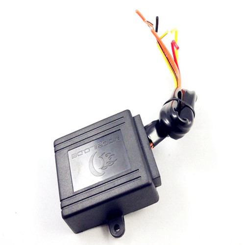

    So I went on a search to add it to my 89 325i that I daily. Couldn't find a diy so I took some pictures along the way.
    The main thing I wanted to do was wire it only into the switch so I could remove it by only replacing the turn signal switch, no actual harness cutting.
    I bought this module from eBay Germany.
    http://m.ebay.de/itm/1x-3x-Komfortbl...082?nav=SEARCH
    Then I removed the steering wheel and turn signal lever.
    I used their instructions and the etc, made this wiring chart :
    -------------------------E30---------------------------------------Komfortblinker
    +12v-----------------Green/Violet-------------------------Red
    GND------------------Brown----------------------------------Black
    Left Input----------Blue/Red from Relay-----------Orange / Black
    Left Output-------Blue/Red to connector--------Orange
    Right Input--------Blue/Black From Relay--------Yellow / Black
    Right Output-----Blue/Black to connector------Yellow
    You have to cut the relay output signals to put the one touch relay in line, which is why I wanted to do all the wiring on something replaceable. The +12v and GND are just splices.
    There's also not much space under the steering column cover so I put the splices near the connector to put it closer to the pedals.
    (ignore the green/yellow splice, I cut the wrong one and had to rejoin it)
    I soldered on all the wires trying to keep them neat and tidy.
    After this I added a zip tie by the splices for strain relief.
    After that, I just plugged the connector back in the car and put everything back together, and it worked perfectly the first time.
    Here's a video from before I put the steering wheel back on.
    I think I got the module cheaper, more like 40 euros, but for that much plus some solder and flux and about an hour, it works great.
    Hope someone else finds this interesting.
