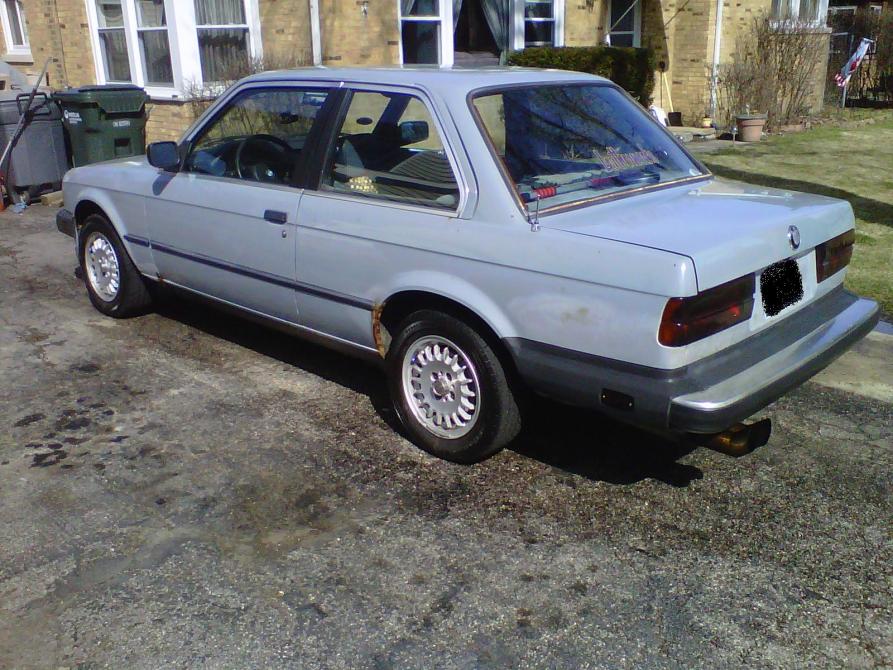

                    My problem is I have an exhaust tip in the way. So I gotta find something that is sticking out and at the correct height to only push the bumper in and not the tips. Any suggestions?
                    Pic for reference.
                    Basaltblau 318i (Sold) Dammit do I miss these cars... Someone sell me one!
                    2011 VW GTI 6 speed
                      Yeah man, just look under you bumper. There are two bolts holding the shock to the bumper. undo each of them and voila bumper is removed. now drill your shocks and sledge hammer them in. reattach bumper with the 4 bolts total and you are set. that way you wont hurt your exhaust. Or just put some wood against your bumper and sledge it. kinda like back in the day how you could hold magazines up to a nerd before you punched umm so it wouldn't bruise.

                        I thought the rear bumper was the hardest to do? I was hoping I could just drill the shocks with the bumper still on. But I guess I'll have to take the back bumper off.. The front I can leave on luckily...

                            Before I did my rear plastic swap, I drilled the shocks and hit up a near by brick wall. I ran into that thing a good 6 times hard and the bumper never moved. Thats when I gave up and put the plastic on.

                                The rear bumper shocks actually have 3 bolts not 2, one is above the muffler shield and the other is on the other side.
