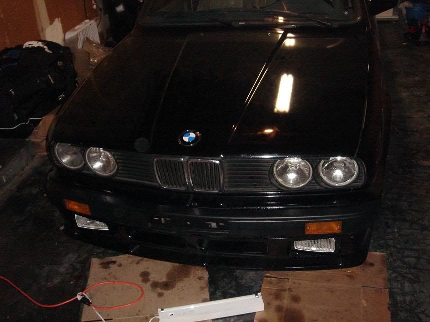

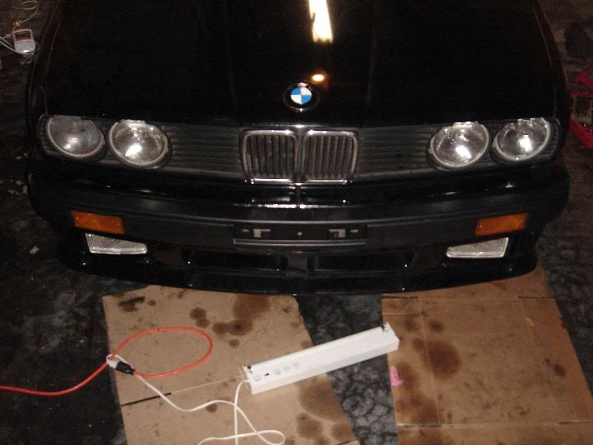

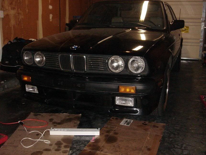

        thanks for the replys

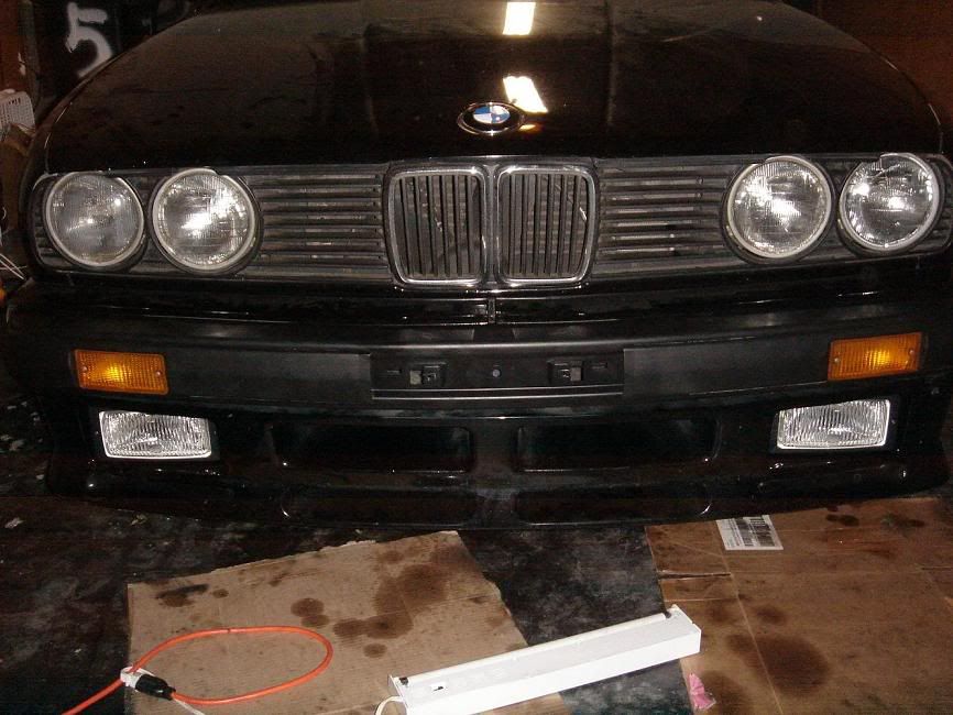

        I was able to extend the bumper enough to be able to get some sockets in there. I'm exteremly pleased with the result, especially because I painted them. Maybe a couple weeks ago I got sick of my broken shitty looking foglights and forked it over to bavauto for new glass ones. With all of these adjustments combined, I have to say it turned out even better than I expected.
        I'll post some pics in a little bit.
        • sharksforthecup
          • Aug 2007
          • 246
          #109
          Heres a few pics and yes it could use a bath.

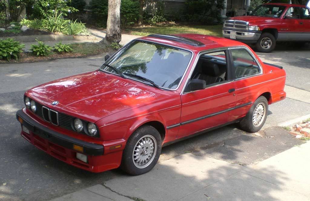

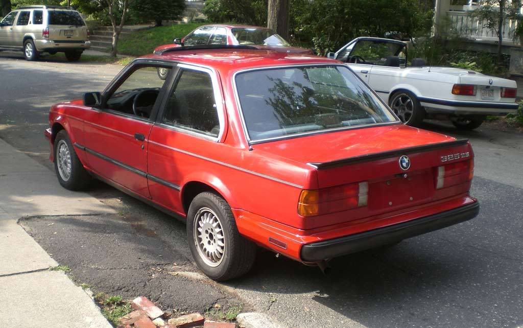

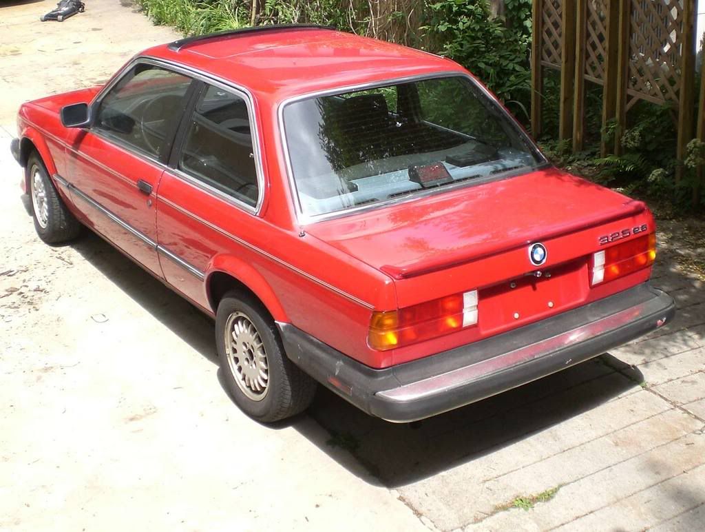

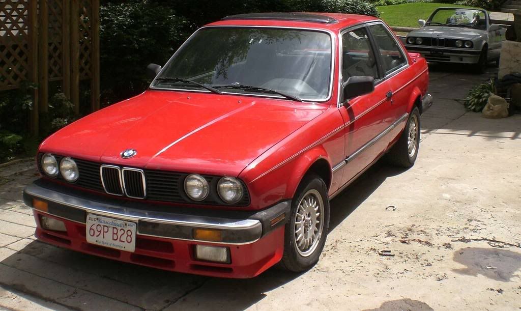

                                #120
                                before tuck (minor in front, non oil filled shocks), body colored (kinda) shrouds and flat blacking:
                                after:
