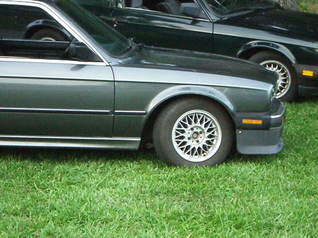

                    This is how you really tuck-in the bumper, all the freaking way.
                        that looks sick! I'm doing mine today, once I figure out this damned fuel pump relay issue.. ARG..
