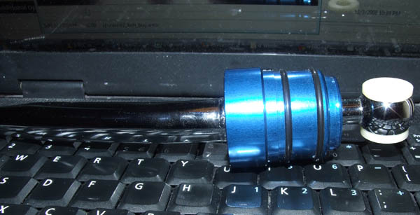

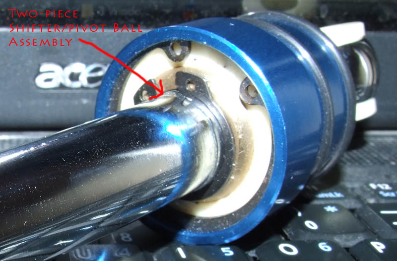

Some shift levers already have these bushings built in. If any material sticks out beyond the metal of the base, then it has them built in.
It will go on all the way and should be a tight fit (you dont want it to move around and create slop). You will be able to turn it though.
