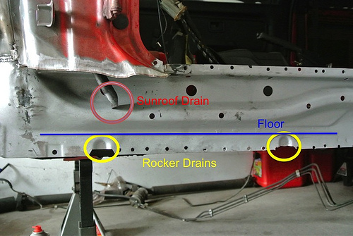

                              #104
                              where exactly are the rocker drains located on the car? any diagrams?
                              • reelizmpro
                                • 9559
                                #105
                                This is the best picture I could find...that shows exactly where everything is. Thanks Striker. I had read that the front sunroof drains dump out of the fender holes but they don't. They actually dump inside the rocker sills where the water eventually finds its way out through the two rocker drains. Problem is, they are hard to find and can easily be clogged or crushed. People who do bodywork on these cars probably don't put much thought into the sunroof drains.
                                1. I would replace and/or grease the sunroof gasket to minimize the amount of water that gets passed it.
                                2. Perhaps elongate the hose and enlarge the 'fore' drain so that the hose now dumps outside the car or just drill a new hole and rust proof it. I believe Luke mentioned this and it's a good idea if you live in a wet climate.
