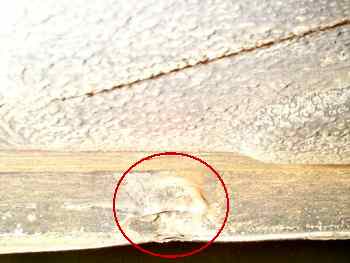

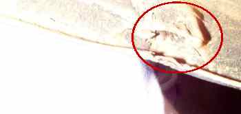

    Time to revitalize this thread. I think this picture sums up the source of my leak. The car was recently repainted and I think they inadvertently sealed up the driver side rocker drains when they applied new undercoating/paint to the rocker panels.

        #108
        Originally posted by CirrusblauS52
        http://www.r3vlimited.com/board/atta...1&d=1394419384
        Great pic! Thanks. Will take this to the body shop when getting the rusty rockers fixed.

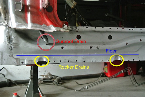

                      I finally pin pointed the rocker drains were not draining. They had been crushed closed by something. The sunroof would drain into the rocker and eventually fill up enough to spill over into the floor pan via holes for the wiring harness.
                      This is very easy to test (details for an E30):
                      Start with car on level ground and fill the forward sunroof tube slowly with water, it should immediately start streaming out as fast as you pour it in via the "fore" drain. The rear sunroof tube does not drain into the rocker.
                      [ATTACH]111674[/ATTACH]
                      Next point the front of your car up a steep hill and again fill the front tube, the water should stream out of the "aft" drain.
                      My car had two drains per side. These were merely indentions in the sheet metal seam. All 4 of my drains were crushed closed.
                      I used a screwdriver to open them and was greeted with a rush of water held in the rocker.
                      BTW, My car took on water once more after this. It happened when my car was parked with the front down a VERY steep hill. The problem was the "fore" drain is located about 8 to 10 inches from the end of the rocker. This allows water to pool up and spill over before it reaches the drain.
                      This phenomenon was immediately remedied with a 1/4 drill bit!!

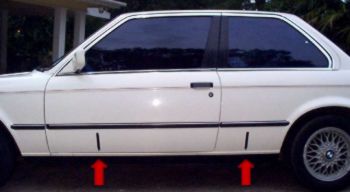

                      The rocker drains are hard to see...get a good light and crawl under there...remember...mine were CRUSHED so I actually saw them a DOZEN times and did not know it... you are looking for a "perforation" in the sheet metal right were the rocker "seams" with the floor pan.
                      [ATTACH]111673[/ATTACH]
                      [ATTACH]111672[/ATTACH]
                      The "fore" drain is approx 6 inches behind the door/fender seam, then the "aft" drain is approx 6 inches in from the end of the rocker.
                      These drains are SMALL, and are hard to describe... they are essentially indentions in the sheet metal.

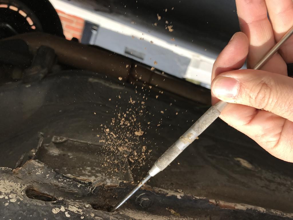

                          This thread was super useful. I had ton of dirt stuck in there and no more wet carpet for me. Thanks!
