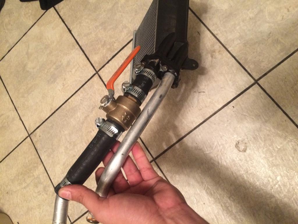

                    Budget/manual Heater control valve
                    My heater control valve started leaking really bad on me. Replaced the heater core and a makeshift manual heater control valve ... This was not the final product . Had to make a few adjustments at the end, but the idea is there
                      Lamont and Rollo would approve of that rig!
