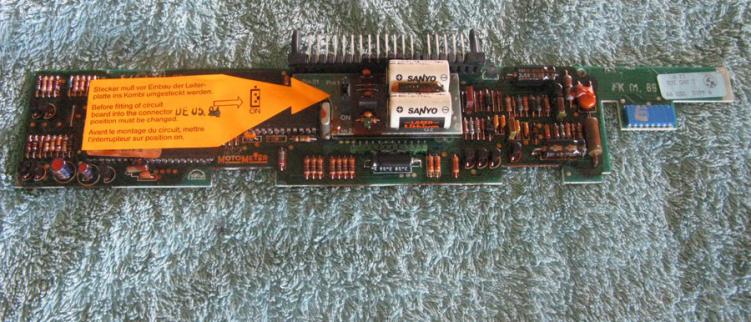

    The board is definitely hacked. Probably, somebody tried to bypass the batteries.
      Considering this is a series 2 or late model board...wtf were they trying to accomplish?
      Ill try to remove that switch then and replace batteries proper
      • Vincenze
        • Apr 2019
        • 984
        Some of SI boards have a jumper to disconnect the batteries when the board isn't installed.
        This long orange arrow points to it.
        Maybe, the owner tried to make the board to operate without the batteries.
        Click image for larger version  Name:	SI%20Board%201.jpg Views:	0 Size:	67.0 KB ID:	9976289
        • Gregs///M
          • Mar 2012
          • 2459
          This is usually done by Programa I believe. They place the switch on there so that when it sits on the shelf, pre-sale, the batteries will not drain. Keep in mind your NICD battery SI board only last about 3-5 years so you will have to refurbish it every 3-5 years. Lithium boards, like pictured above last 30 years. Very important to replace all the transistors and caps, aside from the batteries. I have seen many hundreds of SI boards die from people changing the batteries without replacing the other components.
