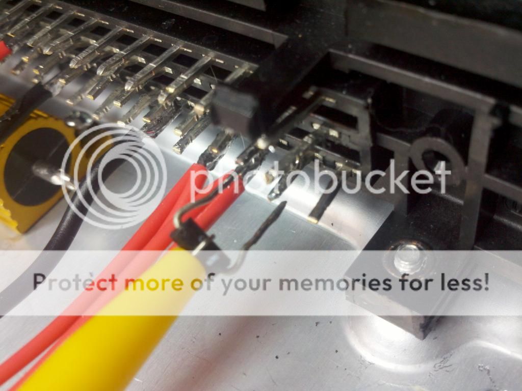

Yes, that is the kit I bought. I clipped the pins off the old board and left them in the connector. I trimmed them down about 1/2" just enough to get a good solid connection. It takes a steady hand to keep the wire on the pin and solder it.
yellow "grabber" things help too, especially with holding that diode in.
and this helps too if your hand is too shaky.

Alright what about on the other end? From the 55 pin I see you wired it from the plug they give you in kitYes, that is the kit I bought. I clipped the pins off the old board and left them in the connector. I trimmed them down about 1/2" just enough to get a good solid connection. It takes a steady hand to keep the wire on the pin and solder it.
I pretty much did what Ryan did in the link below, except for the idle control. I just used a resistor to pull it closed.
I used the 37pin connector from the kit for the wires, and used a straight 37pin d-dsub male connector for the board side like the one below
