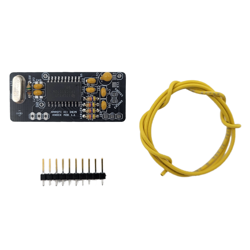

              How good is the signal conditioning of the megasquirt? A quick google suggest you have to add a signal conditioning board, like so
              Enhance your MS3 ECU with this advanced knock module add-on board. Features programmable filters, per-cylinder adjustments, precise knock detection.
              reckons the bandpass is prorgammable, so you can program in the knock frequency from above. but not sure exactly how you program that board :S
