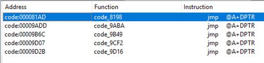

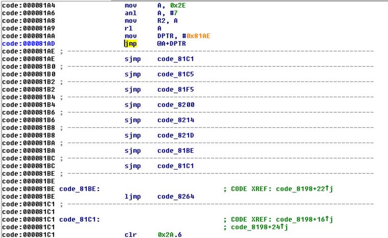

                        As for the "JMP @A+DPTR" I found 5 instances of this which seem to be in code regions. The SAB80C515 reference manual also describes this as a way to make a decision-tree, which is what it looks like in IDA.
                        5 addresses where this instruction is found:
                        Example of the decision tree:
                        The checksum makes more sense now, I was not accounting for the fact that the 40K addressing is different than the 32K addressing when looking at the EPROM dump. So yes, you are correct!
                        The "RESERVED" instructions are gone now that I properly marked more of the data sections.
                          Yes, you absolutely right! I'm a dumb, skip this parts of code... I'm add this info (and how to fix offsets) in my first post and will say this in the following messages.
