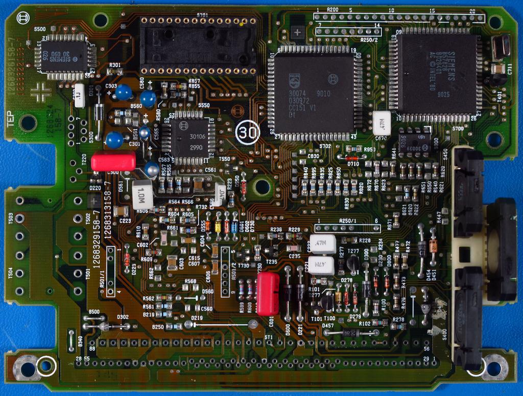

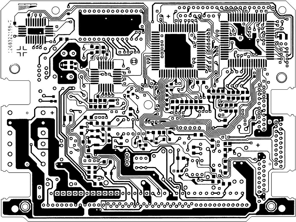

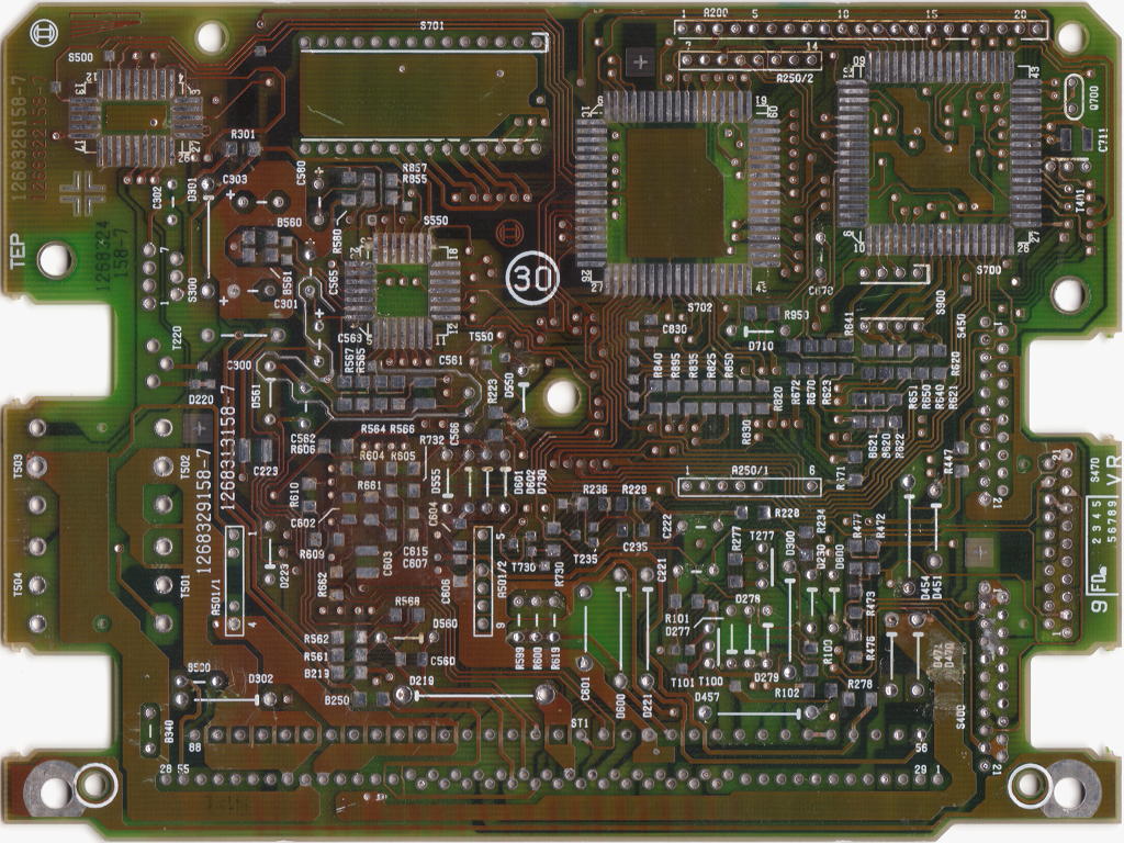

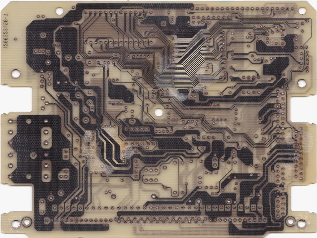

    First, in order to understand the main PCB, I needed to build a schematic of the components on it. I started by getting detailed images of the populated top and bottom sides (a few of the larger components had been removed years ago). Each of these is actually 9 photos stitched together (the board was panned under a zoomed-in camera to get higher resolution).

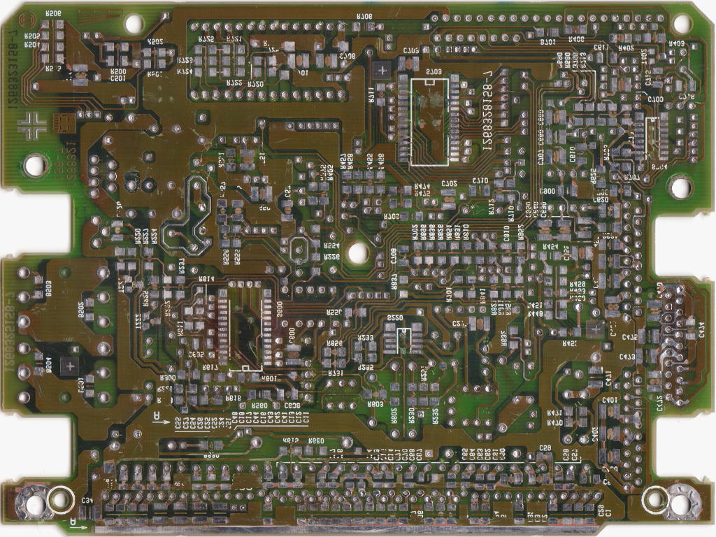

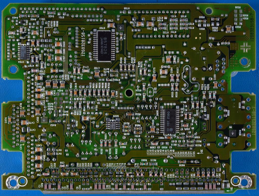

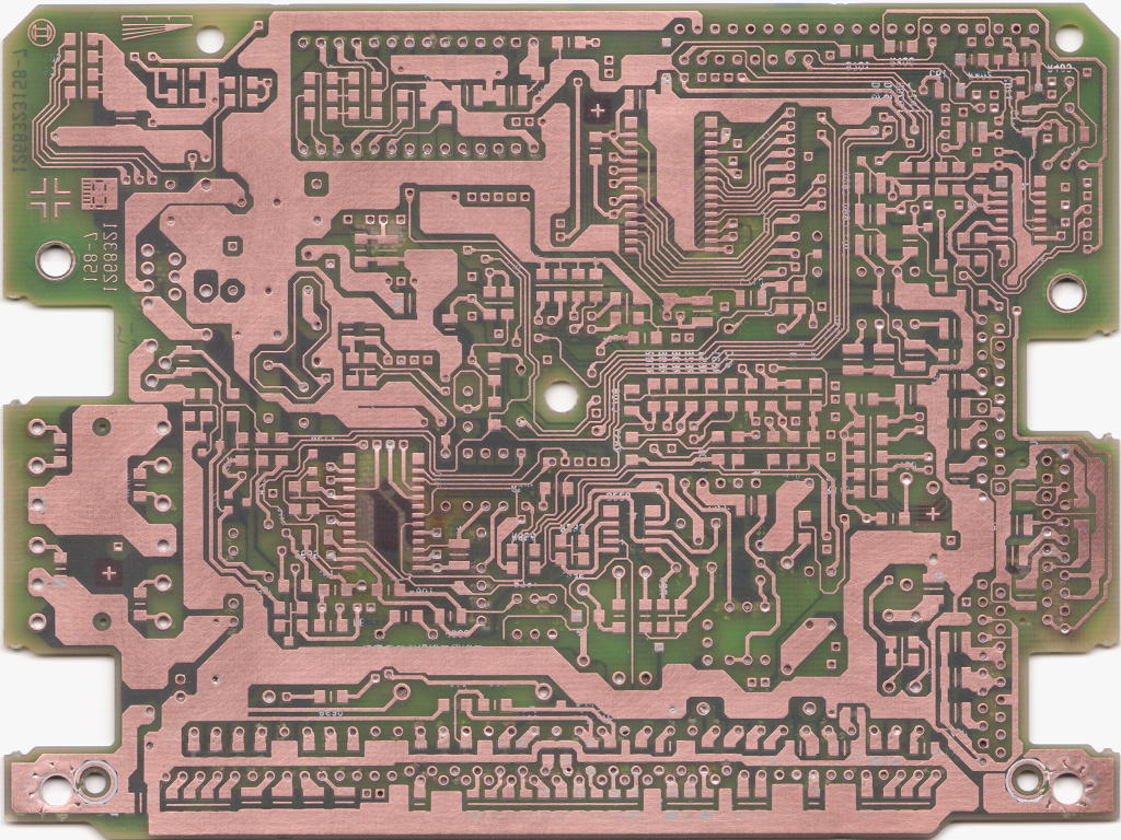

    With that done, I depopulated the whole thing. Lots and lots of soldering iron action! I used a heat gun on some of the larger surface mount parts, which was sort of a mistake since the heat caused the internal layers to blister under the components. The problem with this arose later, which you will see. If I were to do it again, I would carefully use a Dremel and cut-off wheel to slice the leads at the plastic package and then remove the remaining leg pieces with the soldering iron. The PCB images hereafter were made with a flatbed scanner.

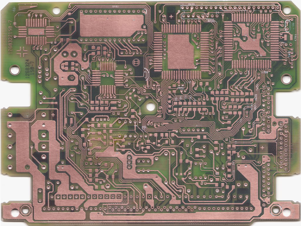

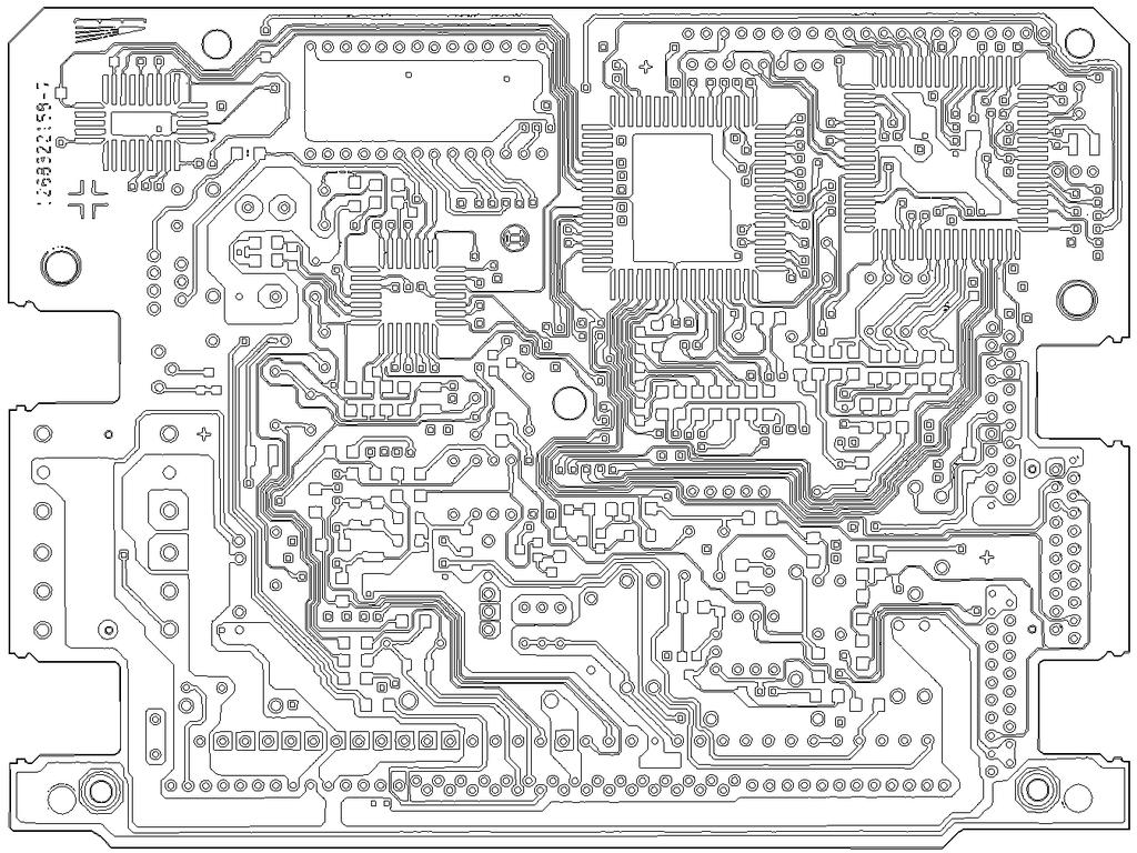

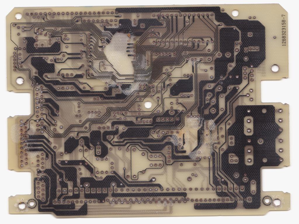

    Next, the green solder mask layer was removed. I looked all over online for ways to do it chemically, but the chemicals required are a) not really accessible to hobbyists, and b) I don't need cancer. Instead, I got some 3M abrasive pads for metal polishing (they are a lot like the green scrubby pads you find everywhere, but more durable and finer) and attached them to a buffing attachment for my drill. This ended up wearing through a couple of small copper areas, but it was easy enough to reconstruct them in my image editor (GIMP). Again, layers were scanned.

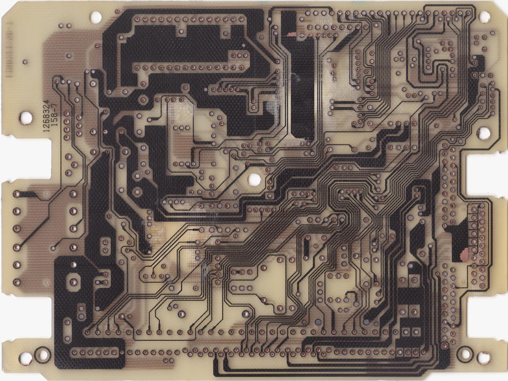

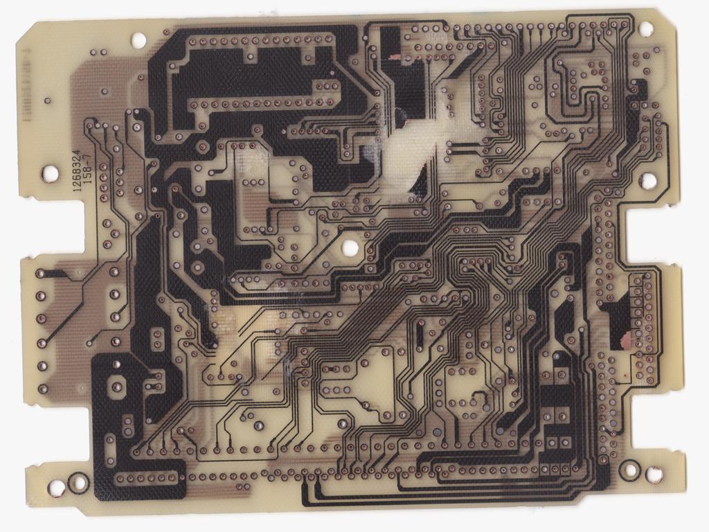

    That stuff was the easy part. This PCB had 4 layers, so seeing the outer ones was not going to be enough. Again, I scoured the web for ways to separate the layers, but there really was no good way of doing that. The main methods seemed to be to CNC the outer layers off, or spend hours and hours working with sandpaper. Since I have access to a manual mill at work, I used some double-sided tape to hold the PCB down and carefully removed the outer layers with a 20mm diameter end mill making ~0.25mm (~0.01”) deep passes. This worked surprisingly well.
    As I had mentioned above, the layers blistered when I used a heat gun, and this caused some of the internal copper to be chopped off during milling.
    It was no big deal. This is because copper cannot cross copper on a layer, so matching up what-went-where was pretty simple via deductive reasoning. Also, I could see "through" the outer layer scans enough to confirm things. There were no vias (inter-layer connecting holes) in these areas, which is why they blistered as badly as they did, but it also meant that traces went exactly where they look like they did. I reconstructed the damaged areas in GIMP and had nice complete pictures of the inner layers.
    That was the easy part of it. I next needed to threshold the images to black/white so that I could use a free program (IMG2CAD) to convert them into DXF vector paths and import them into my schematic/layout program (DesignSpark PCB, free and very capable). There was a lot of manual touching-up to be done to get things to threshold properly, and I probably spent 6 hours tweaking the images in GIMP before vectorization. I also marked every single surface mount pad and plated through-hole so that those would be clear and obvious when I proceeded with future steps.
    (layer 1 for example)
    While I was marking pads and holes, I also noted dimensions of things. This was used to build a complete library of schematic symbols and components for the layout. Every single component was going to be accounted for in my reconstruction.

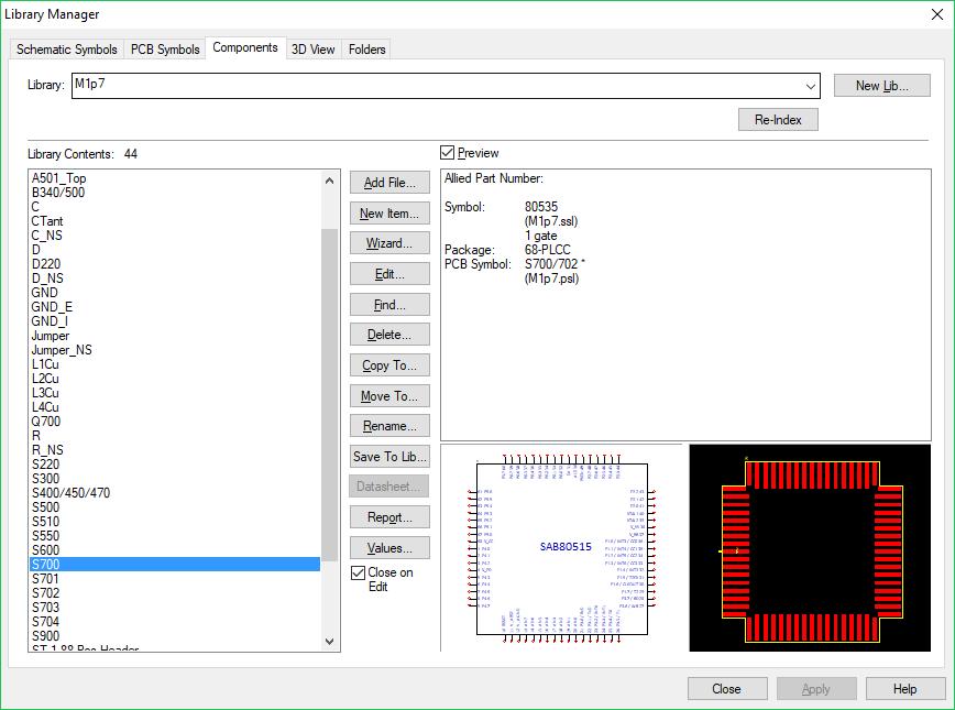

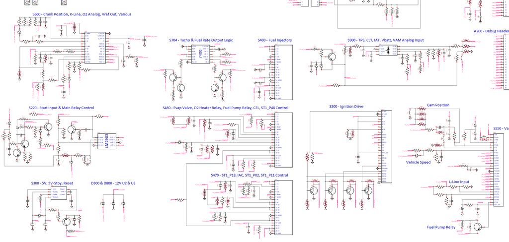

    Here is where the real "fun" began. My intent was to have a schematic for the PCB so that it would be very easy to see what was what when I started messing with the firmware (which IO pin controlled what). Unfortunately, the standard for PCB layout programs is to start with a schematic and then drive the PCB components and netlist (terminal connections) from that...not the other way around. DesignSpark does allow you to create nets (connections) in the PCB manually, but it has no way of pushing them "backwards" into the schematic.
    I almost gave up at this point. Building the schematic meant tracing all of the DXF geometry in the layout, exporting a text file which listed all of the PCB-only net names & connections, and then going into the schematic side and manually making matching connections & naming nets. Everything would have to be made exactly the same, manually. It was essentially like having to rebuild the circuit twice, one component and net at a time. Ultimately, I sucked it up and did it. It was not as bad as I thought it would be, and maybe 30 hours of work to do both workflows. Now I have a fully accurate PCB that is completely driven from the schematic, so when I do decide to make hardware mods to the mainboard, I can fully track and represent things.
    The PDF files in these links have the schematic and PCB artwork. The schematic is not well organized for viewing in a PDF since things are all separated out by subsystem with net labels indicting connections (a text search makes it easy to find endpoints though). This was to avoid having 200 crossed wires to wade through, since with the actual schematic in DesignSpark it is really easy to highlight nets and know what is connected where.
    It is pretty interesting to see what was and was not populated on the board. These ECUs were used in all sorts of vehicles, and you can tell that the design was modular. Also, many of the pins on the main 88-position harness receptacle are connected to things on the PCB, but not used in the M42 wiring harness. Alfa Romeo used these on various 4 and 6 cylinder models, and the E36 M42 used M1.7.2 which is (as far as I can tell) the same main PCB but with the A250 daughter-board installed which processes knock sensor signals. I am actually planning to run my car on M1.7.2 once I get the firmware fully decoded so that I can eliminate E36-specific stuff like DISA control while also gaining knock sensing, but regular M1.7 is first since it will be 95% of the work needed anyway and my engine runs on it now.
    There are a few partial schematics out on the web for other Motronic versions, and those were pretty helpful in figuring out what was what in my own ECU (meaning giving accurately descriptive names to nets). These included M1.3, M2.3.2 and M3.1. They all share enough in common with M1.7 to be super helpful. The M1.3 and M3.1 schematics are only partially complete and have a few errors in them, but I appreciate whoever it was that took the time to try to build them. The M2.3.2 one was posted on a different forum by a random member who was interested in RE'ing it, and it appears to be a 100% complete scan of an original (hand drawn!).
    (Disclaimer)
    None of these are mine, I did not make them and they were all found in various publicly-available parts of the internet where they were posted and/or created by others.

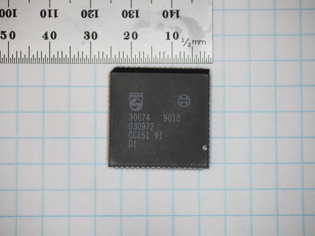

    With that monster task out of the way, it was time to start digging in to the firmware. I have a program which disassembles 8051 microcode, so getting it into a rough representation of the assembly code was fairly easy. Separating out data constants from code is still a work in progress, as is determining what all of the RAM locations are storing and how chips like S500, S550 and S702 work. My main focus has been on S702 lately since it is critical to tons of functions. It is a port expander of some sort which seems to be a custom part made for Bosch to work with the main microcontroller. It is common to all three of the above listed Motronic versions, as well as mine, and I am sure it was used in others.
    I have found how it is accessed in the firmware code and I understand a few of the instructions sent to it and how they control or read various pins. There is much more to it I think, like an internal timer/counter and other output functions which seem to be logical combinations of other input pins (such as pin 67 which seems to have its output programmed to be (A13 OR A14) OR (NOT A15)). I am not sure that I can figure this all out from the code, and since not all pins are even used in M1.7, I am going to need a lot more info on this thing if I want to use it to add functions.

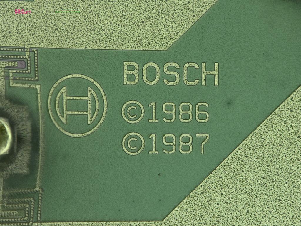

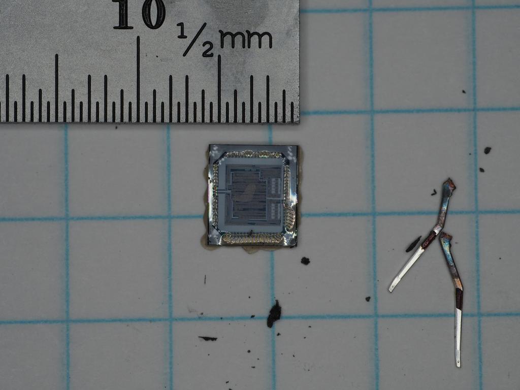

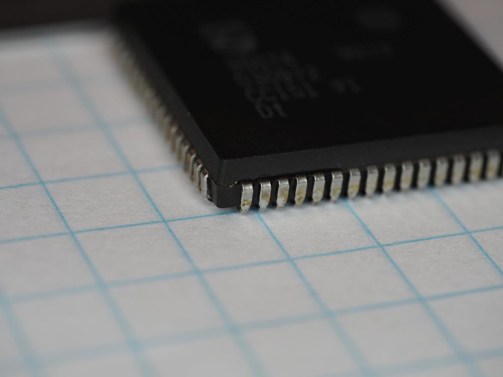

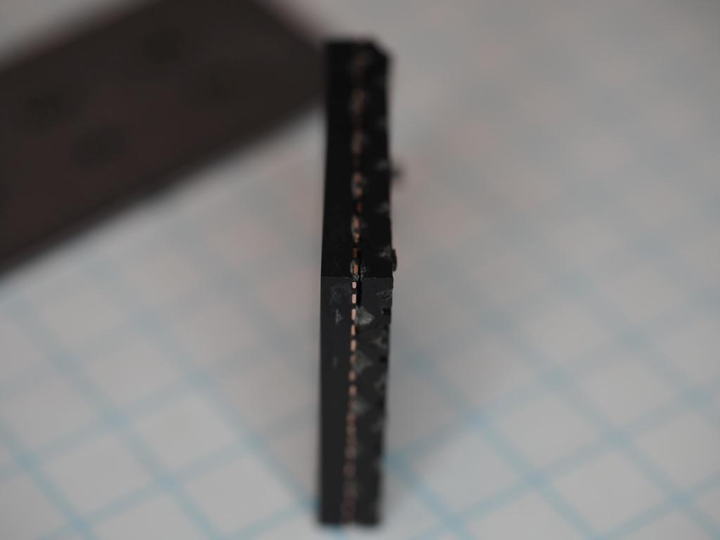

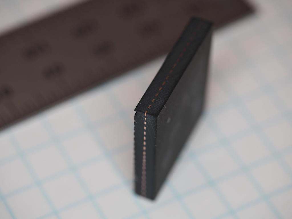

    So, it was time to break in to S702 to start getting some idea of how it worked. "What?" Yes, literally breaking in to the chip to image the silicon die. I work in the electronics industry and my employer has some pretty high-end measurement equipment which they do not mind me using after-hours, so it's not really as silly as it sounds to literally look at the internal silicon. I had the S702 chip from the board I deconstructed above, so I just needed to get the epoxy encapsulation off. I wanted to do it chemically, but that involves sulfuric acid heated to 250 Celsius...no thanks. I found a method that just about anyone can use at home, and as crude as it is, it works.

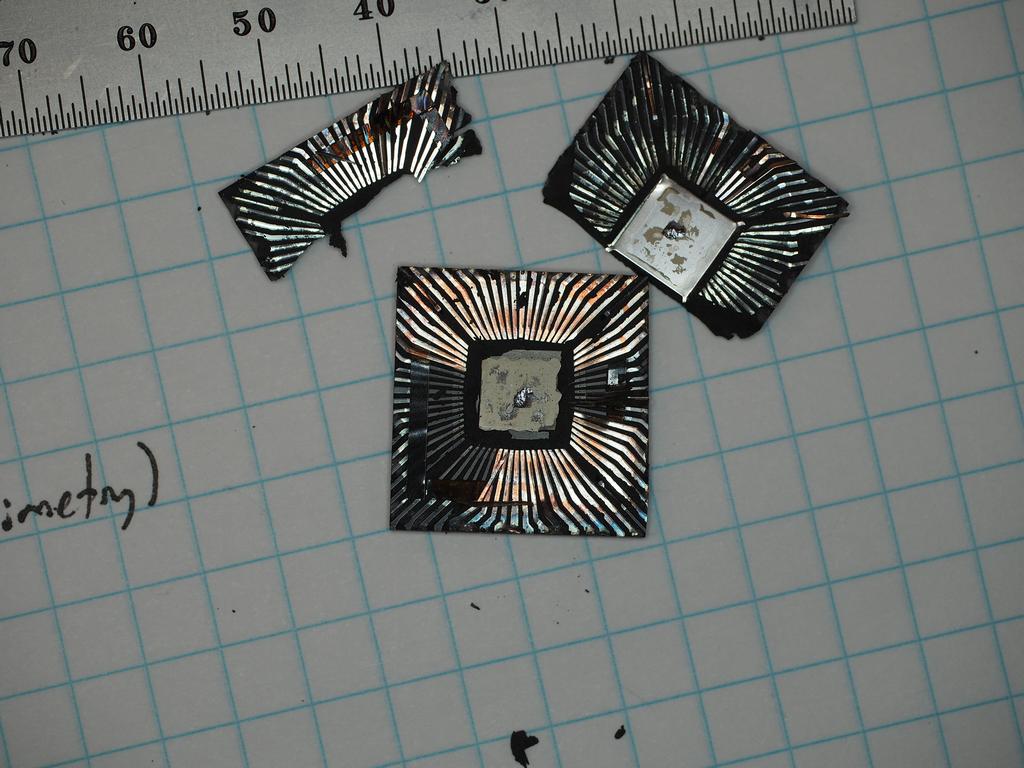

    I started with the chip and ground off the metal leads to get clean square sides.
    Then I stuck the chip in a cheapo bench vise, aligned the centerline with the top of the jaws and compressed it. I repeated this a few times, rotating the part, and it quickly popped apart.

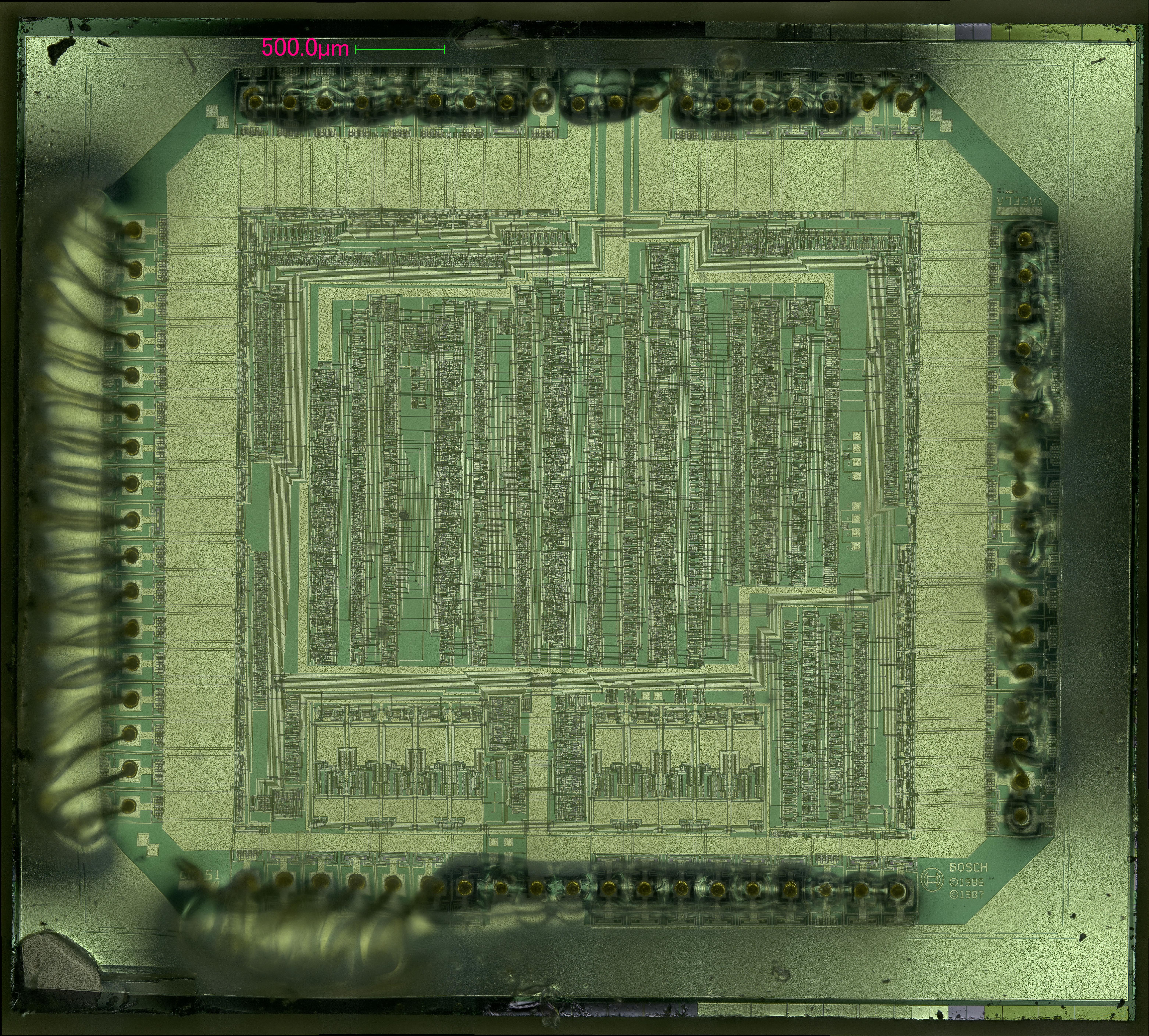

    Voila, the actual functional bits of it. The actual "chip" is the little silicon die with all of the micro-features etched & plated onto it.

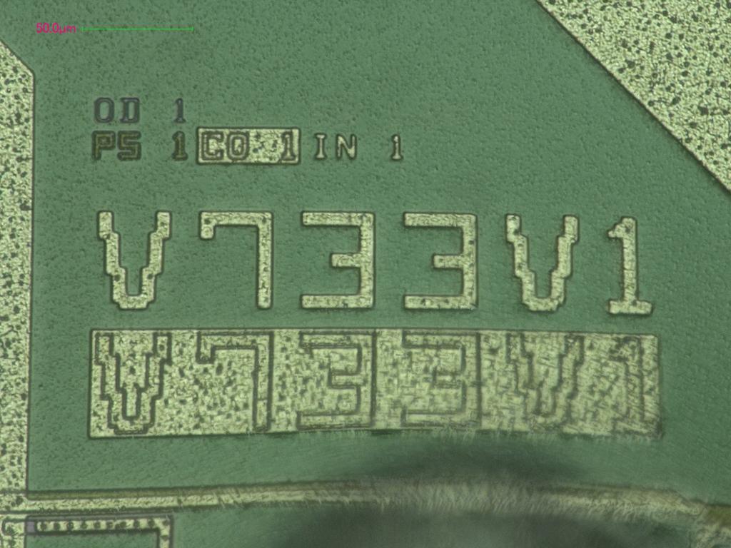

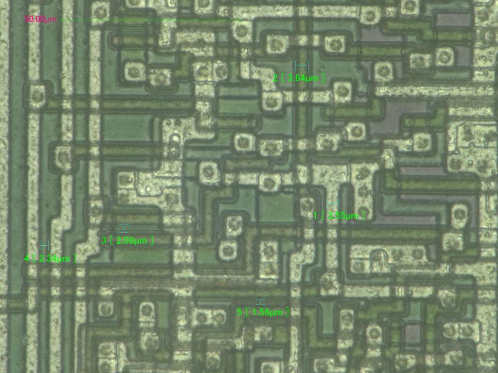

    As I had said, I have access to various imaging equipment at work. Since the features on this are relatively large, an optical microscope was all that was needed to get a reasonable amount of detail from the die. The microscope I used does automatic 3D stitching, meaning I specify a 3D bounding box and it scans through all of the Z-heights, composites everything into perfect focus, pans to the next X/Y locations, repeats the Z steps and then stitches it all together into a big panorama with everything in focus. It is one of the lower magnification instruments in the lab since it only goes up to 2500X, but its automation functions make it one of my favorite instruments.
    This chip was made with something around a 2 micron process (2000 nanometer, versus modern chips which are made with 10-30 nanometer processes). The link has a larger version, which is still a lot smaller than what I got out of the microscope, but more than enough for internet enjoyment. The distortion around the wire bonds is due to the fact that there is a clear adhesive encapsulation about 0.25mm thick covering the whole die. It was easy enough to see through, so I left it on.
    300X mag die overview shot:
    Full-size image (~8MB): http://www.e30tuner.com/assist/m17re...2_full300x.jpg

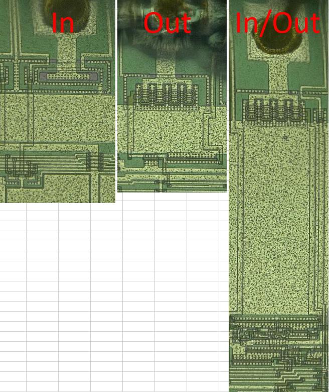

    The smallest features/spacings were on the order of 1.5 microns. These images were taken at 500X to 2500X magnification.
    I am not about to go and try to trace out all of the individual transistors and logic gates since that is a lot of work, and it is probably faster to figure out what I need to know by messing with the firmware. But this was worth the effort since I was able to clearly identify three distinct pin types. Knowing which ones were inputs, outputs and bi-directional has been very helpful in understanding the command structure used to interface with it.
    Inputs have a single metal trace coming from the wire pad, outputs have two and bi-directional ones have three.

                        Originally posted by bmwman91
                        I double-checked the PCB images, and the connections that I made in the schematic seem to be correct (AN6 and AN7 are linked to two pins on A250 through two not-present resistors).
                        I rechecked asm listing, and found that you correct! Thats what do I call walking around for years, without right schematic. But AN6 is NOT KS1 or KS2, its something else but 100% not knock sensor, because its not readed in crank-syncronised interrupt. In this regard, a huge request will figure out the scheme M1.7.3.
                        M1.7.2 not worth paying attention, if you want I can give a detailed answer, why should switch to M1.7.3 and not to M1.7.2.
                        I'm already swaped M1.7.2 to M1.7.3 on my car.
                        The internal ROM from my ECU matches exactly to the M1.3 ROM, and it matches partially to the M1.7 ROM that you posted. Which version is yours from?
                        Its from M1.7.2 and M1.7.3. I have guess that ROM is not hardly strict to Motronic version, but for DME part number, so most likely it depends on the year of release. I called ROM some time ago because of ignorance this fact. If you try to disassemble M1.7 with 1.7 ROM you will notice that all OK and if you want to recalculate checksum with 1.7 ROM, you notice that all OK too.
                        Also, I found a way to use an Arduino to directly communicate with the MCU, without needing to deal with the K-Line and L-Line. It involves some soldering to connect direct to the 8051 Rx and Tx pins, plus the L-Line endpoint on S550 to send the 5-baud address to initiate communication. I will try to put together some details on that here.
                        No need Arduino for communication with old Motronic, just need $5 cable with BMW 20 pin adapter, and soft used all around the world :) I wrote about this later.
                        • bmwman91
                          • Oct 2004
                          • 3134
                          Thank you for confirming the ranges of data constants. So 4000h-5BFFh are data, maybe it is all used, maybe not, and the last 288 bytes. Is that all of the constant data that you know of?
                          Understood about the sections with no XREF's. There are one or two large ones, and a number of small ones (some I was able to fix because they use "JMP @A+DPTR" which cannot be properly traced without real emulation).
                          I can update the schematic to give "unknown" names to the AN6/7 nets since I am only guessing there. Can you take some photos of the top and bottom of the main board so that I can see the layout? The part number etched into the main board is 1268322158-7. My guess is that M1.7.2/3 have the same main board, but maybe different daughter boards in A250 and A200. So, depending on this I might be able to build a complete 1.7.3 schematic for you.
                          Let me know your thoughts on why M1.7.3 is superior to M1.7.2. I am happy to learn and consider that for a conversion. There are many on eBay for OK prices, all in Europe since no US-version BMWs had the M43. There seem to be two versions of 0261203277, a silver label one and a gray label one. Do you know the difference between them? One eBay listing says that the gray label one has the EWS/immobilizer, which I would probably want to avoid, but if the firmware is being accessed then it can probably be removed.
                          EDIT: I got info from the eBay seller and the gray-label one has no immobilizer. So I purchased one from Italy for $50 with free shipping and should have it next week.
                          As for the ROM, the interrupt vector table seems to be exactly the same, so interrupt calls will jump to the correct location in EPROM, but much of the other stuff is different. Some of it looks like code, some looks like data constants, and of course there is a lot of FF!
                          Looking forward to your info on the $5 cable to communicate with. I could not find a KW71 interface box that looked like it would work for less than $120, so I just used the Arduino directly on the DME.

                            Also,
                            A long time ago I found a simple EXE on some random website to calculate checksums for a few different DME's. I disassembled the EXE and got the exact algorithm used for the checksum in M1.x. It is pretty simple. Again, addresses are referring to those on the 32K EPROM, not the proper 40K image.
                            CSUM = MOD([SUM(0000h:1EFFh) + SUM(2000h:7FFFh) + 46367], 65536)
                            This 16 bit value is then stored at address 1F00h:1F01h (MSB:LSB).
                            The EXE I found (not mine, I take no credit for making it) is here. It seems to support a number of variants (run through command line):
                            Transaction Feedback: LINK
